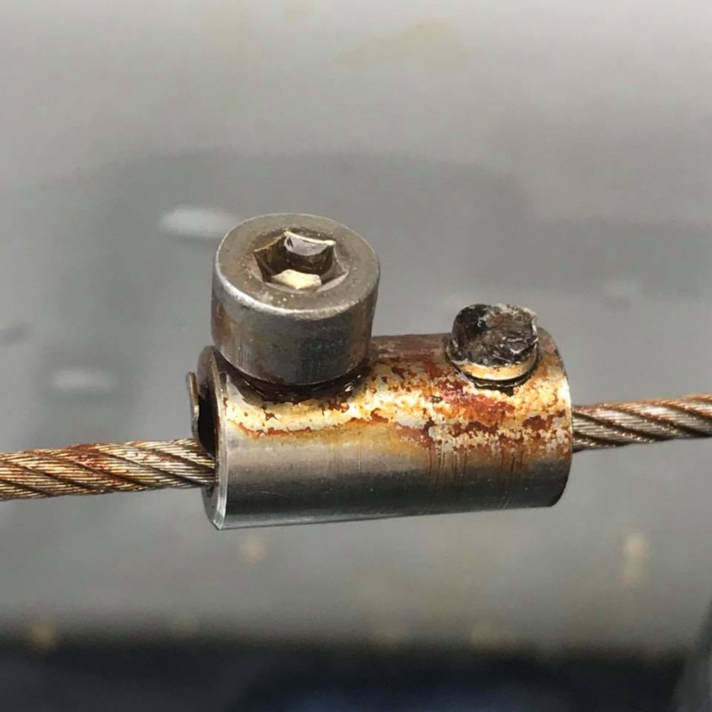

8 years 2 months ago #31345 by hamishglen
Any decent tips on getting the stripped bolt out?
8 years 2 months ago #31346 by HankL
Soak it over nite in a product like Blaster and then use a pair of vise grips.

8 years 2 months ago #31356 by Wombat661
Replied by Wombat661 on topic Fenn (old school) cable connector bolt fail..
Chances are if is stuck enough for the head to shear off, you will not be able to turn it with what is left of the bolt.
If this is on the boat, I would put a piece of wood under it. Have someone use a vice grip to hold the connector steady. Use a file to smooth out the top of the screw. Use a punch to punch the center of the bolt.

8 years 2 months ago - 8 years 2 months ago #31358 by Atlas
You’ll be replacing the rusty cable right? Spend ten bucks and buy a new cable connector from Ocean Paddler. You could really spoil yourself for twenty bucks on a matching pair.

8 years 2 months ago #31361 by Oskar
After first removing the other screw I've always been able to get the broken screw out easily with a pair of pliers. While at it replace all 4 screws with M3 grubscrews.
8 years 2 months ago #31365 by Watto
You nailed it Atlas. Three other bolts likely to be compromised plus rudder cables themselves clearly rusting out. Replace the lot.
