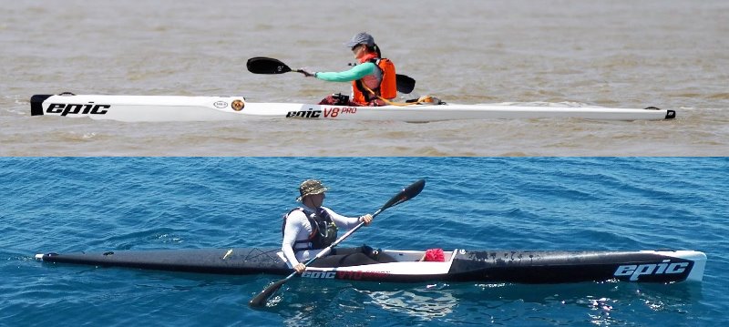

7 years 4 months ago #33577 by leolinha
Thanks for all who answered this topic so far.
As I said first and confirmed here, most people seem to believe that black-tip
Epics are tougher, although the red-tip ones can take a lot of abuse too.
I currently own a V10 Sport "elite" (full carbon layup). In another thread, as I had just bought my new ski and was still highly impressed by it, I said that you never regret buying the best, that the elite layup is not fragile etc. By now, however, my ski already went to the repair shop three times and I am not so excited about it anymore.
I am seriously thinking about exchanging my carbon V10 Sport for a black-tip V8 PRO (the Epic dealer offered me that deal).
In my city I am the only surfski paddler. I live in front of the beach, but there is no bay here; I have to handle the shore break everytime I get in and out. I would feel a lot more confident in a more robust boat. The downgrade to a V8 PRO is motivated by its side handles, absent in the V10 Sport, which I think add value and comfort, as well as off-water handling safety, since a black-tip Epic is reasonably heavier.
Almost all my paddler friends have advised me to NOT doing this, saying that “you will lose performance”, “you will regret exchanging a superior boat for a cheaper one”, “you will lose resell value” etc. Those guys come from a very competitive background, they live on a bay and paddle on V10 - V11 - V12 - V14 kinds of skis. They paddle in groups most of the time and one can notice that group feeling in which anyone considering a change from, say, a V10 to a V10 Sport would be immediately regarded as a “loser”. They cling to seconds, everybody wants the fastest boat at any cost.
But I think that these concerns are somewhat exaggerated. Talking about performance, for example. There are many posts in this forum regarding boat comparisons like V10 Sport vs. V8 PRO. Also, many posts addressing the “light boat vs. heavy boat” question. If we take all that for granted, we must believe that a carbon V10 Sport must be considerably faster than a fiberglass V8 PRO. However, my previous boat was a regular black-tip V8 (not PRO) and from my own experience I can say that my speed gain was subtle, although I have been paddling my carbon Sport over a year now and feel pretty comfortable in all conditions. That being said, I believe that the speed difference between V10S and V8P, whatever the layup, should be marginal.
Even the differences in weight and stiffness seem overrated to me. We are not talking about a rotomolded boat like a V7; a fiberglass V8 PRO should weight 15 kg, what is by no means too heavy. And a relatively short ski like a V8 PRO in fiberglass is not much less stiff than a full carbon, as Greg Barton himself says:
A stiffer surfski will be faster.  It does not flex as much under speed and the rocker profile will remain consistent when weighted with the paddler.  But there is a point of diminishing returns.  For example, there is a larger performance gain moving from a plastic kayak to a composite, but less gain moving from a medium stiff composite to a super stiff composite kayak.( www.surfskinews.com/tech-travel-archive/...n41nedrck1aami2ac808 ).
Anyway, I am very inclined to accept the deal and give away my used black V10 Sport in exchange for a brand-new black-nosed V8 PRO, believing that, in doing so, I will get more durability, confidence, comfort and stability for a negligible loss in performance.
Is there something I am missing here? Any reason for not doing this that I didn’t think of yet? Any comment will be appreciated!
