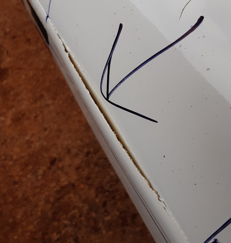

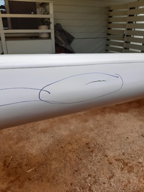

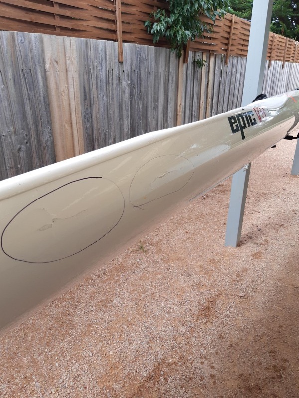

Hello fellow surf skiers, I have attached pics of my EpicV9, purchase new September 2020, a couple of days ago i was on a 3ft wave going across the face of it when it closed in on me, as I went to remount I noticed this damage, there are no reefs to hit and its deep water where I was paddling, this is the second my V9 has been damaged by a wave closing in on me and was told the repair would make it better than new, Epics warranty policy states "Surf damage to surf skis or wing paddles is not considered a manufacturing defect" advice and opions from you surf ski guru's would be appreciated..

5 years 1 month ago - 5 years 1 month ago #38412 by [email protected]
That's a really tough one.
Many years ago I took my brand new full-carbon Fenn Mako6 up to Durban to take part in a race.  Durban has surf, Cape Town (where I live) mostly does not, so I was extremely anxious about the potential for damaging the boat.
The day before the race, I went for a paddle - specifically to practice ins and outs through the surf.  It was a perfect day for it because the surf was small.  I paddled a couple of km up the coast and then turned in towards the beach.  I came in perfectly behind the wave then stuck my legs out to avoid hitting the rapidly shelving sand.  The next (small) wave turned me sideways, but I wasn't worried....  The next (small - considerably smaller than 3ft) wave dumped on me, knocking me off the boat.
No worries, I stood up in the thigh-deep water and reached across for my hat and paddle and walked over to my boat to pick it up and have another go.
Then I did a double-take - the boat looked as someone had taken a chain saw to the hull in front of the cockpit.  Bizarrely the deck was barely creased - but the hull was severed.  All I could do was empty the water out, pick the boat up and trudge back the 3km up the beach to the club.
I went to the nearest hardware store where they gave me a bunch of hardboard off-cuts, which I duct-taped onto the hull to split it.  I sent the boat back to the Fenn factory where they repaired it and I got many more years of use from it.
The point though is that any ski can be broken by seemingly small surf and it's a risk we all take when playing in the waves.  No manufacturer offers a warranty against wave damage.
I popped the seam on my Swordfish S a couple of months ago, coming into the beach at the finish of a downwind race.  I had just been overtaken by one of my buddies and although I could see a big wave coming in behind me, I thought stuff it, I'm going - and ended up doing the first genuine pitch-pole of my life - the wave steepened to the point where the nose buried, the tail of the ski came right over and I was ejected.  Fortunately I'd already undone my leash.  This one was entirely my fault - in any other circumstances I'd have pulled out of the wave and come in more circumspectly.  The pressure exerted on the nose caused it to implode.  Fortunately the damage was confined to the popped seam so it wasn't a difficult repair job.
I'm really, really sorry for the damage to your boat, but, yep, I can understand why manufacturers balk at accepting responsibility for surf damage.

I'd talk to Epic or the Epic supplier. This wasn't surf damage but in the open water, right?

5 years 1 month ago #38425 by sarzelopez
Can you explain what you mean by "closing in on me"?
I wouldn´t think a 3foot wave would crest-out on OPEN water in a way that it could crunch down on the boat like that. It can obviously take you down but overall just give your boat a  big slap.
How deep is "it´s deep water"? Even 20-30 feet is considered breaking/surf zone.
From the pictures your boat got damaged on both sides?
