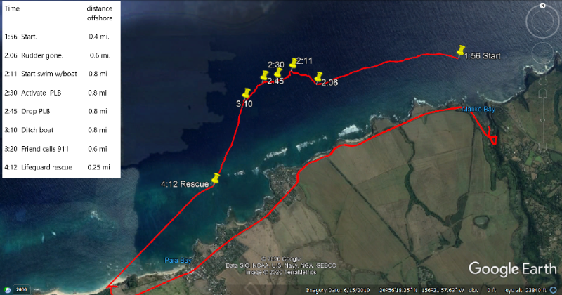

Here's a pic of the timeline, it shows when I activated PLB, ditched boat etc.
Big mistakes:
1: Tether on PLB must NOT have a quick release.  I dropped it after about 15 minutes of transmission.  (WTF was I thinking?)  SAR got a signal for about 15 min, then it vanished.  Big thanks to the pro's out there saving boneheads like me.
2:  Never leave the boat:  I tried to drag it to shore for about an hour.  I inflated PFD, swam with boat about another 15 minutes then ditched the boat.  Sure, I made progress to shore rather than running parallel.  But that's no excuse.  Don't leave the boat.
3:  Never swim away from a friend in a passing boat.  I did.  I was irrational by that point.  I saw him, asked him to call 911.   He did.  He was stunned when I kept swimming and yelled for me to stop and come to him.  I didn't hear him.
Didn't even look.  He tried to loop back to me but it was impossible.   Be careful when approaching a swimmer.  He didn't recognize me.   He couldn't alert the 911 people that it was me, which confused the situation even more for SAR.   Thanks to them for saving boneheads like me.
Anyhow, I made it.  I'll probably have more to say later.  Fight or flight hormones change behavior.  I thought everything was fine out there.   But thinking back, not so much...

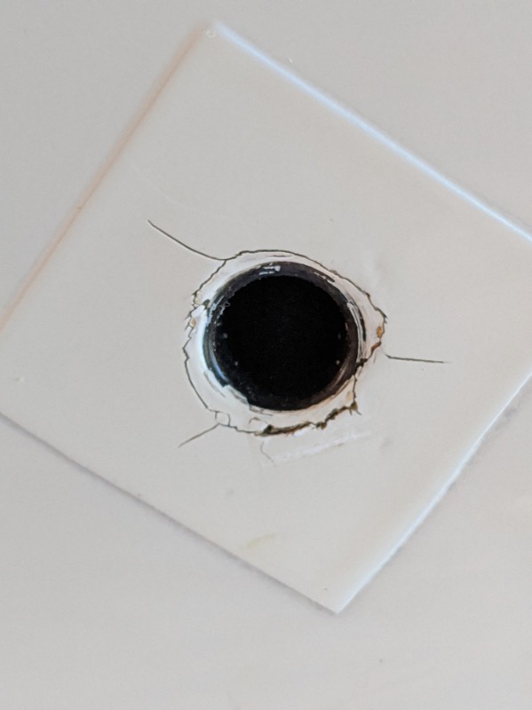

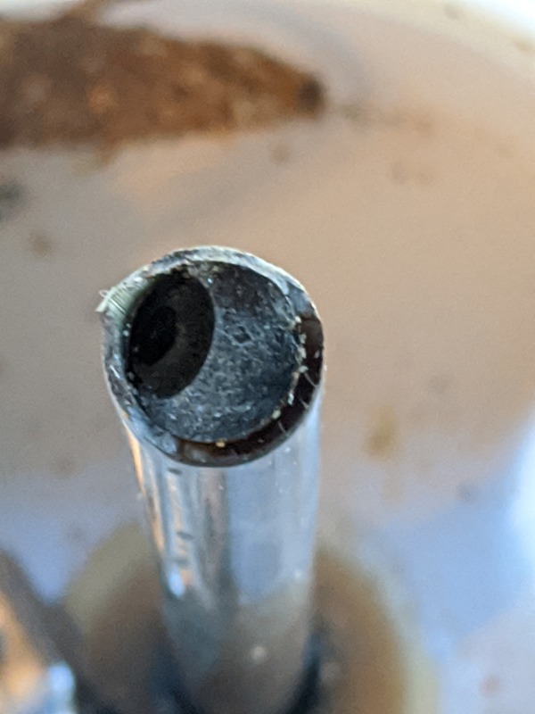

Here's the damage surrounding the steering tube.  Probably hit a turtle, didn't see or feel anything.  I remember catching a great run, then rounding off to the right.  I assumed I had spun out.
About 5 minutes later, I swam to the rear of the boat to investigate.  (Nice to have a waist leash).
Anyhow, rudder sheared off cleanly at  the hull exit.  Remainder of shaft still in the yoke.  Probably due to small fatigue from age/bending it straight/whatever.  Nothing bad to say about the Epic rudder.   Shit happens.  But I am going to order a DK for this boat too.  DK works really good on my 12.
