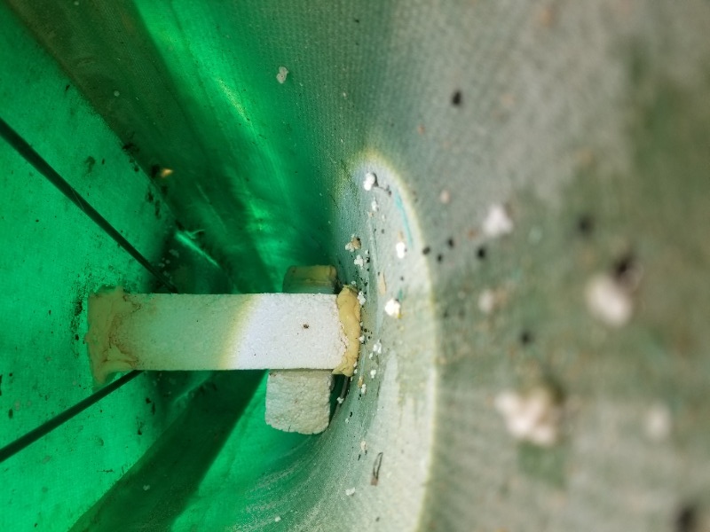

When I picked it up, there was a rattling noise coming from the hull... Eek. As an older ski, my only access was through the drain hole, so I cut a larger hole (planning to add a deck plate when finished).
Looking inside, one of the supports had come loose, and a lot of twigs under the seat.
You do not have permissions to access this page.
I vacuumed out the debris & pulled the loose styrofoam column out.

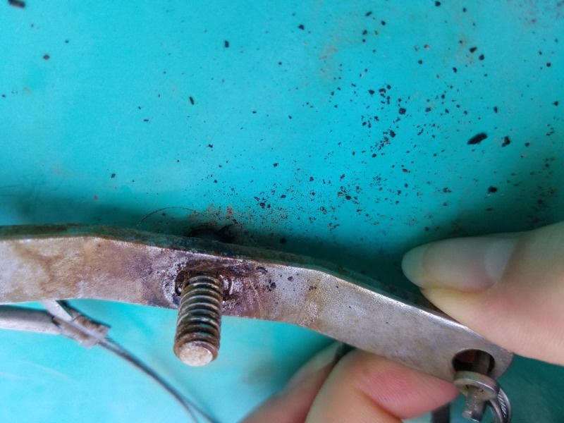

I removed the nut, but I cannot remove the 'swiveling bar to which the cables are attached' .

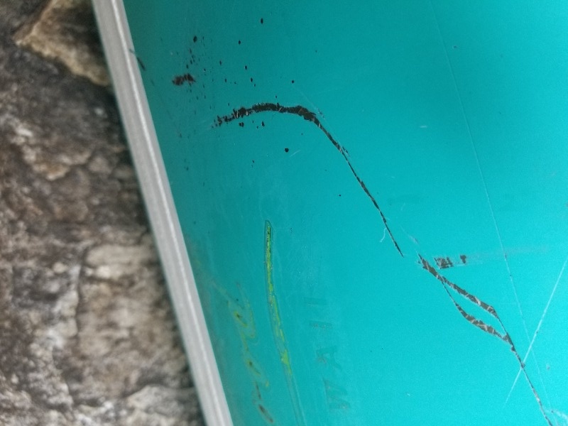

3. Hull
There are some dings, but the ski floats...
And damage around the rudder area:
I have gel coat, the 'stuff you mix with gel coat to make sure it cures without being tacky', catalyst, MEGUIARS polish, & 'orbital buffing tool'.

Skis will survive without interior bracing, especially if you are learning and not exactly paddling big waves.

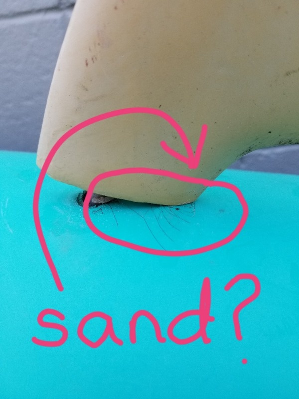

I (obviously) have no experience with boat repairs, so my first instinct was to just sand the rudder at the top where it is rubbing the hull because it's been bent. *
I've already sanded the hull, so the work will commence. Tips on the best way to proceed are appreciated. I am capable and, more importantly, tenacious; I want to make this boat something I can use.

How is the tiller bar attached to the threaded shaft, is there a flat side threaded nut/collar/spacer between tiller and shaft? The whole lot being stuck together due to corrosion? My ski has a square slot tiller and it can take a bit of a nudge to prise it up and loosen off the rudder shaft, and its not old.

Have you already sanded all the gelcoat off the complete hull?  My boat has no gelcoat but is just finished with rattlecan auto paint. Advantage of this is its lighter than gelcoat and you can retouch it or change the colour design at will. Down side is it does chip easily so needs regular touch ups if you want to keep it looking sharp. Though for a quick easy cheap finish for a low value boat it works well and easy to do.

If that tiller bar is just a slip on but corroded on and you have tried soaking in corrosion lubricant to no avail then you can rig up a puller, such as a stiff bar or angle with three holes drilled in it corresponding to the line attachment holes and the shaft. Put the top nut back on the rudder, slip the puller over it and attach end holes with bolts to the line holes. Then back off the rudder nut until it starts to pull on this bar. Thereby exerting an even force on the tiller bar which stands a better chance of getting it off than just tugging and prising it. Hopefully it hasnt been epoxied on due to missing a top nut??

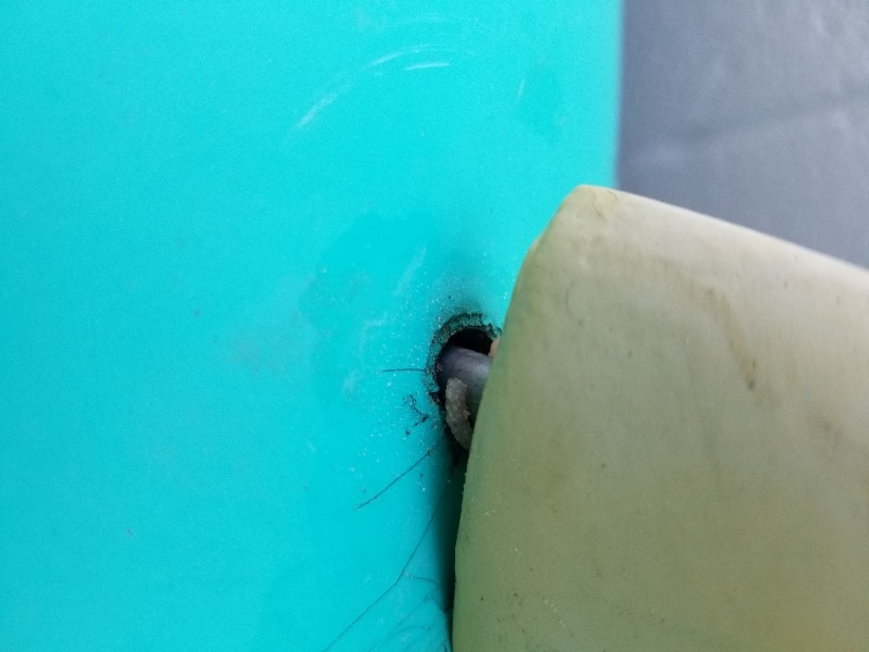

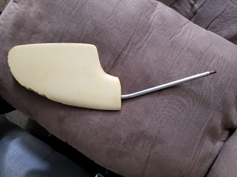

5 years 11 months ago #36811 by NaturalBornTripper
I got the rudder out- I didn't realize it wasn't a twist off.
Is my rudder bent? Or is it supposed to look like that? (see photo)
Is there a way I can order a replacement rudder for a boat of unknown make/origin?
Mahalo!
5 years 11 months ago #36812 by kwolfe
Yeah it's bent for sure right at the base.  It shouldn't be hard to bend back.  I've done it before.  Use a vice or a large set of vice grips and some good old man strength.  Then slap some epoxy to covers the chips and clean up the threads on the top with a wire brush.
I wouldn't spent alot on a nice rudder at this point.
5 years 11 months ago - 5 years 11 months ago #36813 by NaturalBornTripper
Thank you kwolfe!
I was just thinking it may be easier to just buy a new rudder because I don't have a lot of "man strength," hahaha but maybe my friends can help.
Do I vice the shaft or the blade part of the rudder?
If I can't straighten it, will it mess up the boat if I just use it as is?
Last edit: 5 years 11 months ago by NaturalBornTripper.
5 years 11 months ago #36814 by kwolfe
Ha! Forgot about that one when I typed it.  It really shouldn't be that hard to bend.  Especially if it's aluminum.  Give it a shot.  If it doesn't work no big deal.  If it still works as is then it's ok but might not work quite like it should.
5 years 11 months ago #36815 by waverider
Shaft in the vice you dont want to introduce any bending up length of shaft or it wont go back in, and could bind in tube. Without a vice a sturdy steel tube slipped over the shaft and lever on that.
