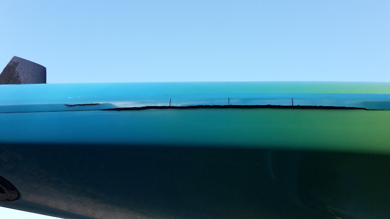

I'm also a happy owner of a viperski since a couple of years. I really love the boat! In the beginning I faced the same problem as you and it took me some time to find out, where the water gets in. Finally I found and repaired it (not too nice, I know). Check the picture!
In the beginning the crack was very small! It increased over time. Today my boat has a second crack exactly on the other side, which you wouldn't recognize as a crack. But my boat got a hatch in the back, so I can look inside. And when I come back from the paddling and I look inside, I can see the drops of water running down exactly from the joint.
Not that good!
Have fun with your viperski! It's great anyway
mirko

6 years 2 weeks ago #36638 by Santome
Replied by Santome on topic Nelo Viper 55 Ski Issue
Thank you for your advice Mirko!
I'll examine in depth if the joints are properly sealed and double check if there is any hidden crack.
