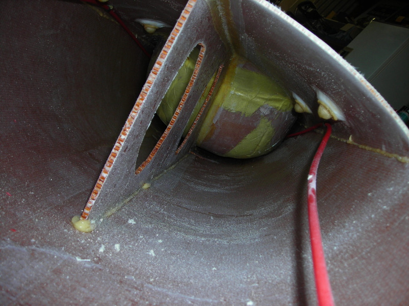

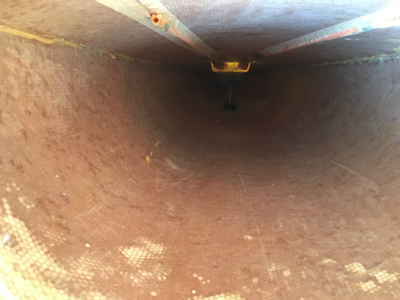

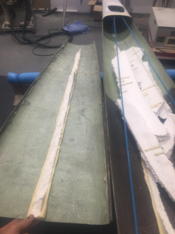

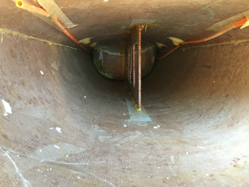

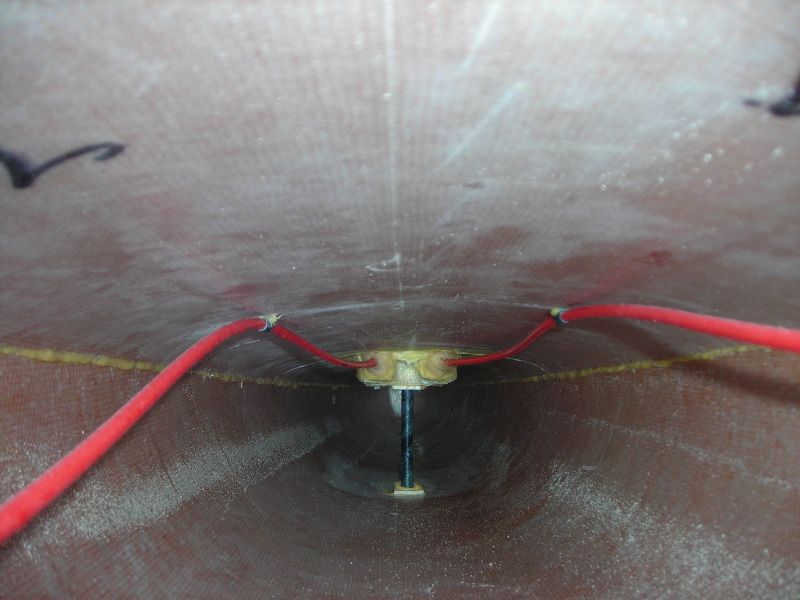

6 years 4 months ago #36266 by [email protected]
Well Ranga, you have managed to be unhelpful and long winded at the same time.  It really doesn't matter if I don't know a screwdriver from a
hammer.  I asked a simple and direct question.  If you don't want to
help, then don't.  Thank fine.
Wind your neck in mate, Ranga is blunt and direct, but he is trying to help!  Especially now in the time of bloody virus, let's assume the best of each other!
He sent these photos, showing the insides of various skis.  (For some reason, he couldn't post them, so he asked me to put them up).

Thanks Rob, those were just what I was looking for.  I just got a borescope that hooks up to an iphone.  Only $30 off amazon.  Hopefully I can snake it inside to get an idea where the tube is sagging.
6 years 4 months ago #36273 by mrcharly
Replied by mrcharly on topic Rudder Line Tube Rattle
Fascinating photos.
I'd assumed that the deck and hull of a surfski would be joined by some epoxied fiberglass (or carbon) tape. From the photos, it looks like is an overlapping flange and glue (polyurethane?) holding them together.
6 years 4 months ago #36275 by Ranga
Replied by Ranga on topic Rudder Line Tube Rattle
First picture is a Fenn Elite S carbon that has no fixings for the rudder line tubes on back deck and the rest are inside Epics.
Epics do not fix the tubes completely, the tubes are free to slide on their fixings to allow for expansion and contraction, they are only fixed at either end. In the pictures they are sagging because as you can see the ski is in two pieces and the tube is not connected. These are old models of skis and construction , the construction of new skis has changed and use different materials but the fixing of the tubes has stayed the same.
As for the joining of the deck and hull there are various methods used. I am unaware of any that use polyurethane as finishing that is not very easy, epoxy and more exotic glues are used. Some have internal flanges and some don't but those that don't would have external fiberglass taped seams.
