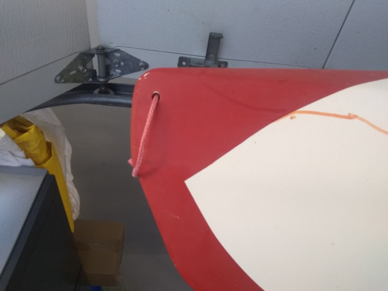

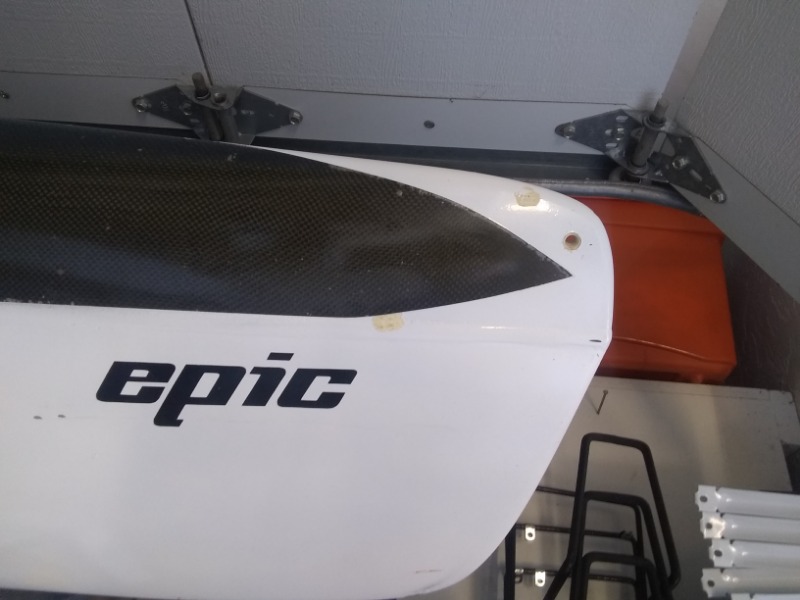

A simple way to add an attachment point to the bow or stern of your ski is to drill a 3/8" hole then fill with thickened epoxy. After epoxy hardens re-drill center with 1/4"
hole. works great and is a very strong attachment point. For leash attachment point I would recommend doing so at the bow. Attaching to stern and using in surf is good way to damage your rudder/steering components.
6 years 11 months ago #34860 by mrcharly
That is a neat job - however I shudder seeing a loop there.
Loops like that are tempting to grab - a boat in a current or wave will easily spin - there is a reason for using T handles on sea kayaks.

Thanks mrcharly. I feel it is a clean simple technique if you don't have bow handles.
I use the holes to tie off my ski to the back of my boat on trips to to the Channel Islands
(Incredible down wind runs). I use foot straps for handles.
