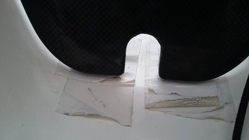

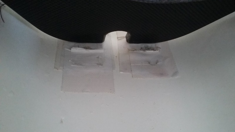

The ducttape will stay a lot better if you use long strips. Mine starts at the bottle holder recession and runs all the way to the front of the bucket. Ducktape is sticky enough to stay, it's just all the heel sliding over the edge of it makes it come off very soon. Just extending it removes the edges from under your heels. Stays a lot better on my V7 (I also taped it heavier than on the pic).
