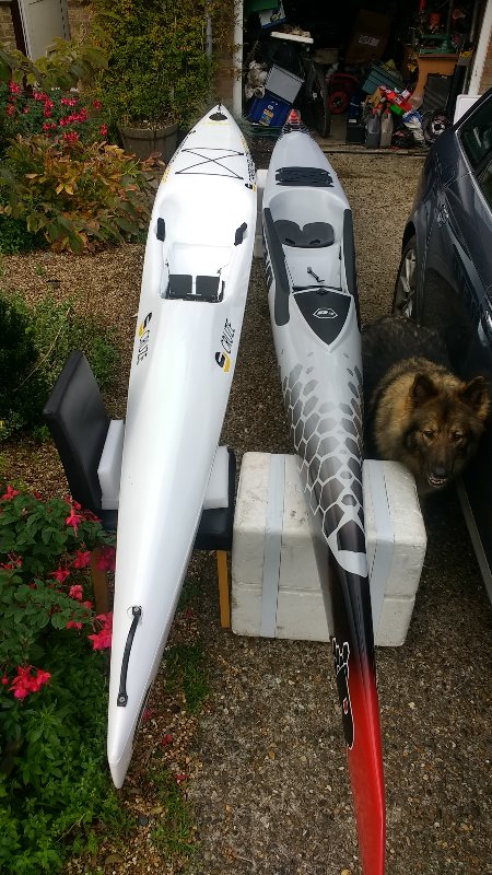

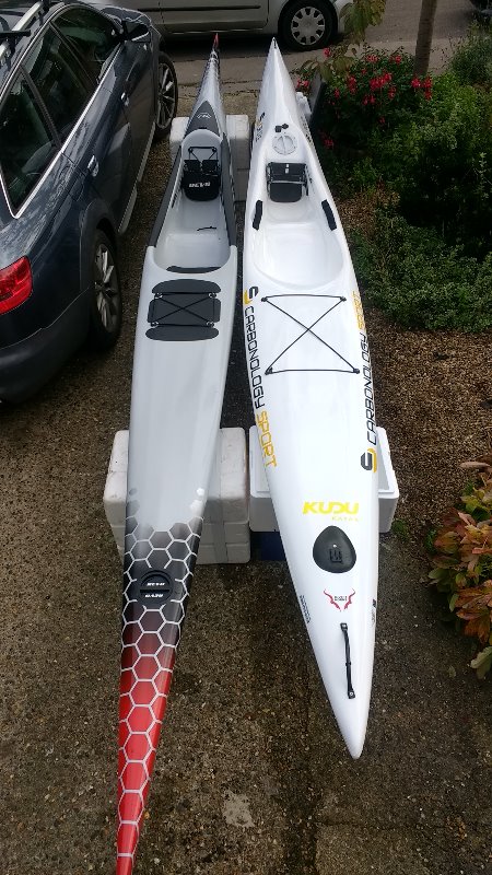

I cannot really answer your question as I have only paddled the two skis above. I put the pictures up as it certainly shows why they feel so different as there is clearly a lot less volume front and back on the R3 than the Cruze and my brain as much as anything needs to recalibrate which it is definitely doing but maybe not as quick as I thought. However I know someone who has paddled the Epic pro and a Carbonology Zest before the R3 and his opinion is the R3 is definitely easier to get on with than the Zest and quite similar to the pro which I have to admit surprises me looking at the pictures of both as the pro appears to have more volume and certainly has a little more width. Listening to other more experienced reviewers than me on the R3 it certainly gets the thumbs up for being stable in the sea and my guess would be that you would find it easier than the swordfish but I wouldn't like to say by how much only a test run would decide that I guess.
