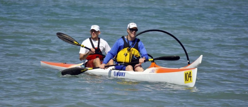

Did you say you have a tandem outrigger setup. Do you mean a ski or OC1 with an outrigger on both sides. I'm considering building either a ski or OC1 with twin outriggers and paddling it with a 2 blade ski paddle. Just trying to find anyone who might have done this before because I don't know if it's possible.
Much appreciated, Damien (Australia)
  • downwinda
9 years 5 months ago #28057 by downwinda
Replied by downwinda on topic surfski vs. OC1?
I think he meant 2 person outrigger. I do know of a paraplegic friend that has outriggers on both sides of his (rudderless) V-1, however the auxiliary outrigger on the right side is smaller and offset from his main ama, so I'd guess it would be in the way of a double blade.
9 years 5 months ago - 9 years 5 months ago #28058 by red_pepper
Replied by red_pepper on topic surfski vs. OC1?
My wife and I have a 2-person outrigger which can be paddled with either canoe paddles or kayak paddles. I also have an extra iako set for my OC1 to allow paddling it with a kayak paddle. No need for a second outrigger on either boat. But if you want one, Huki makes a Dragon boat with outriggers on both sides:
www.huki.com/index.php?page=D1-X
I've also seen a number of pedal-powered boats consisting of a main hull and a small outrigger on either side.
I've attached a photo of our tandem outrigger from a Lake Michigan race I did with a friend using kayak paddles.
