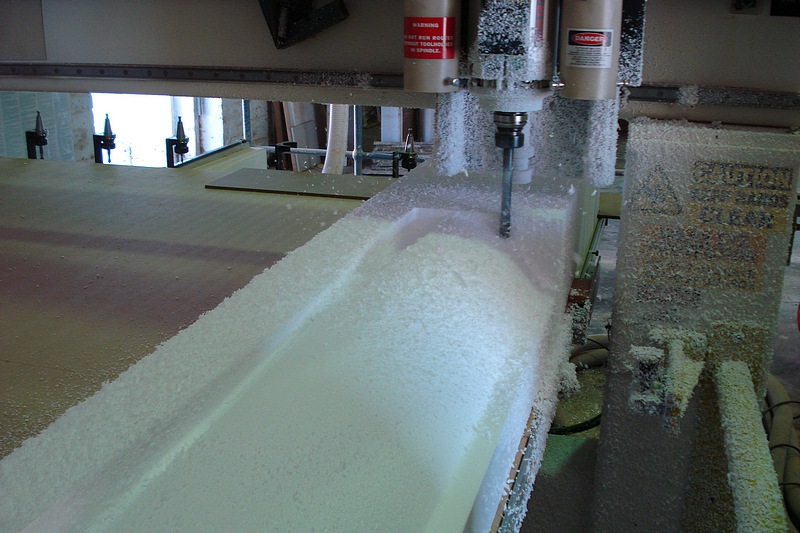

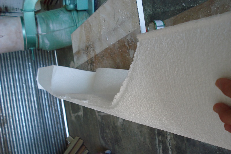

I designed the boat on a CAD program and then cut the shape out of polysterene on a CNC machine, after which I fine tuned by hand and then epoxy glassed the foam.
Above: hull side being cut out

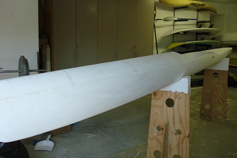

[img]Above: Right hand centre piece complete (pointing towards you) [img]http://www.surfski.info/media/kunena/attachments/legacy/images/js800_FOAM_SANDED_READY_TO_GLASS.jpg[/img]
Above: Polystyrene sanded and ready to be glassed
Above: Epoxy Glassed and sprayed up finished product.
Some stats of the “foamie”.
Polystyrene weighed 3,0kg.
Finished boat weighed 14,1kg (complete, including set up)

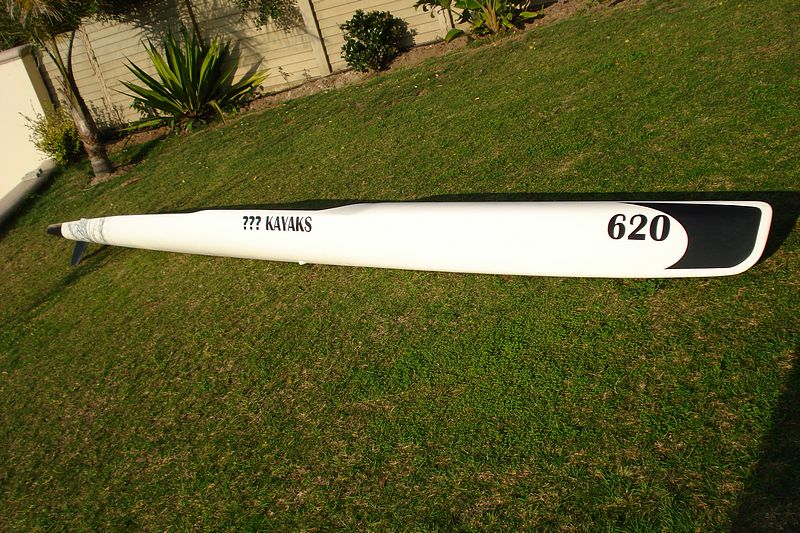

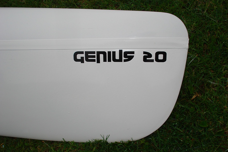

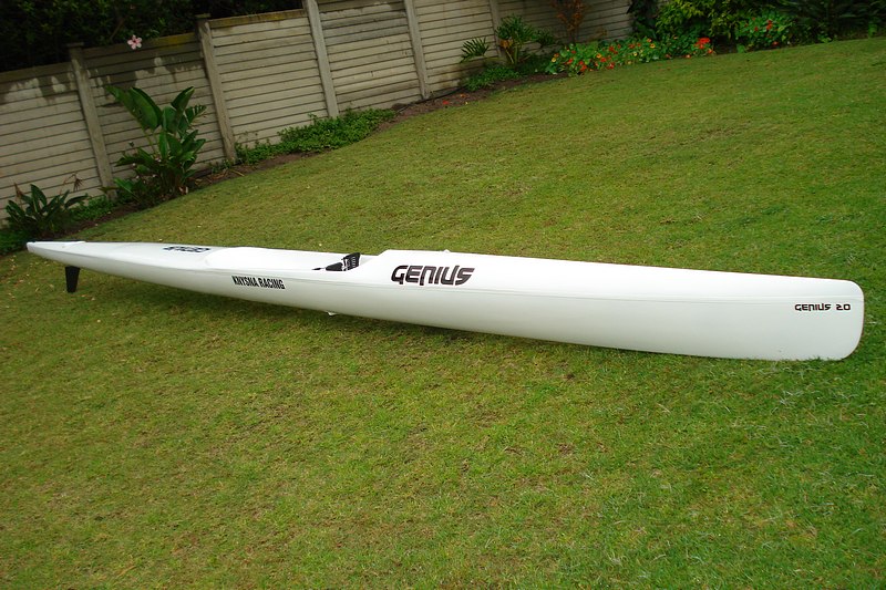

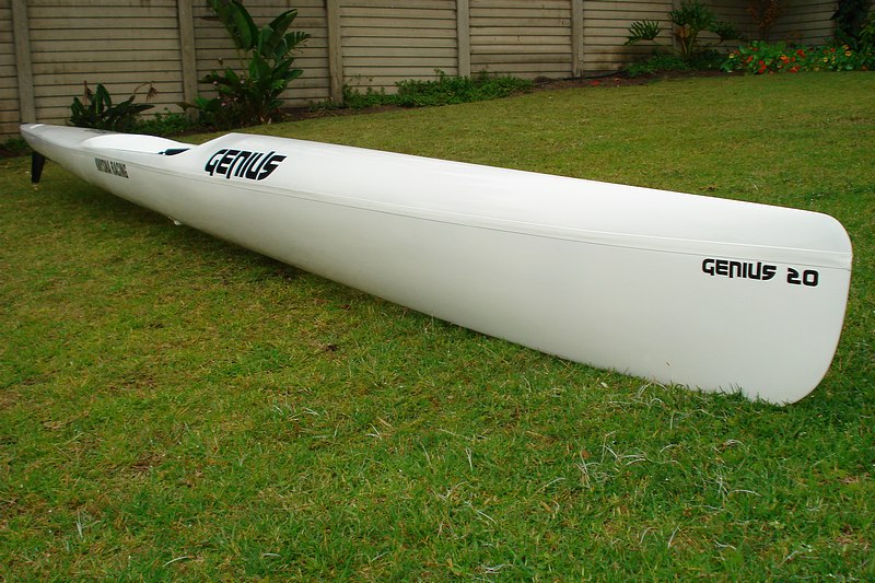

Some more pics of the first ski out the mould below (a plain glass boat weighing in at 15,9kg):

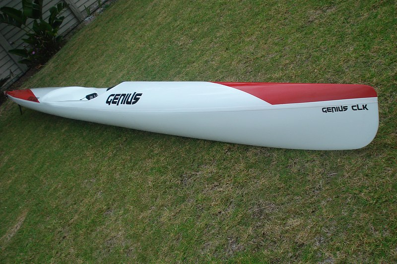

I also built a stable, fast novice boat called the CLK, some pics below: Dimesions are 5,8m long. 480mm wide.
This is also Michele Eray's boat of choice training a top cyclist who has never paddled before to race in a 25km race in 4 weeks, coming up over the Easter Weekend.

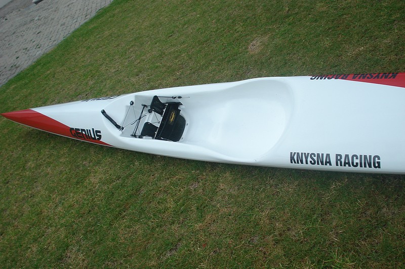

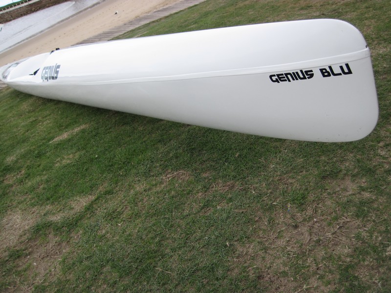

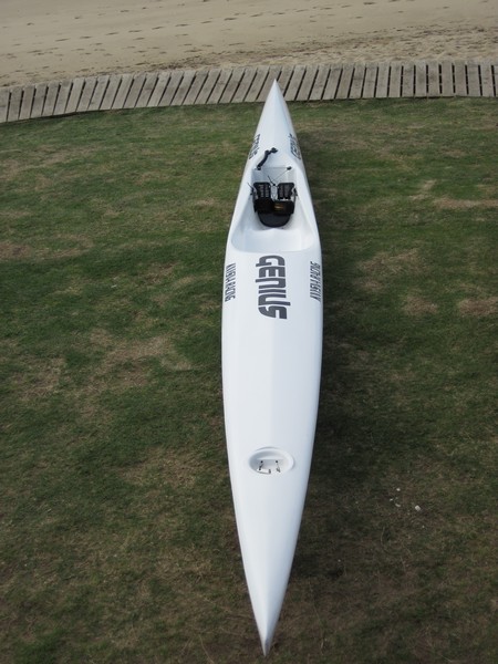

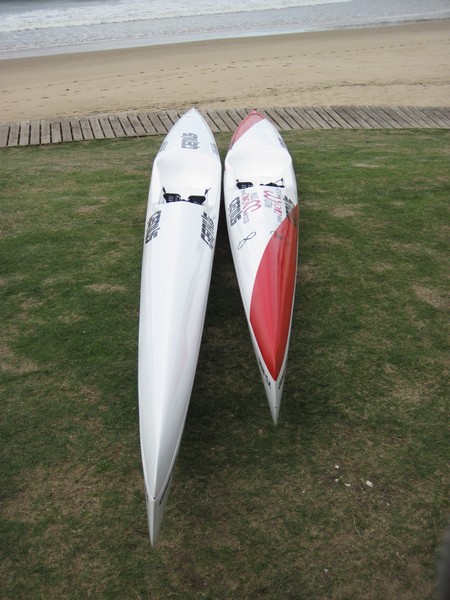

here are some of the pics of the new GENiUS BLU
here along side the CLK which is shorter and slightly wider
