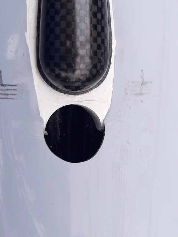

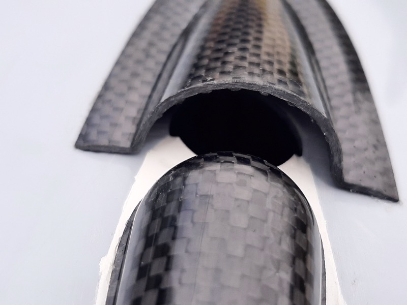

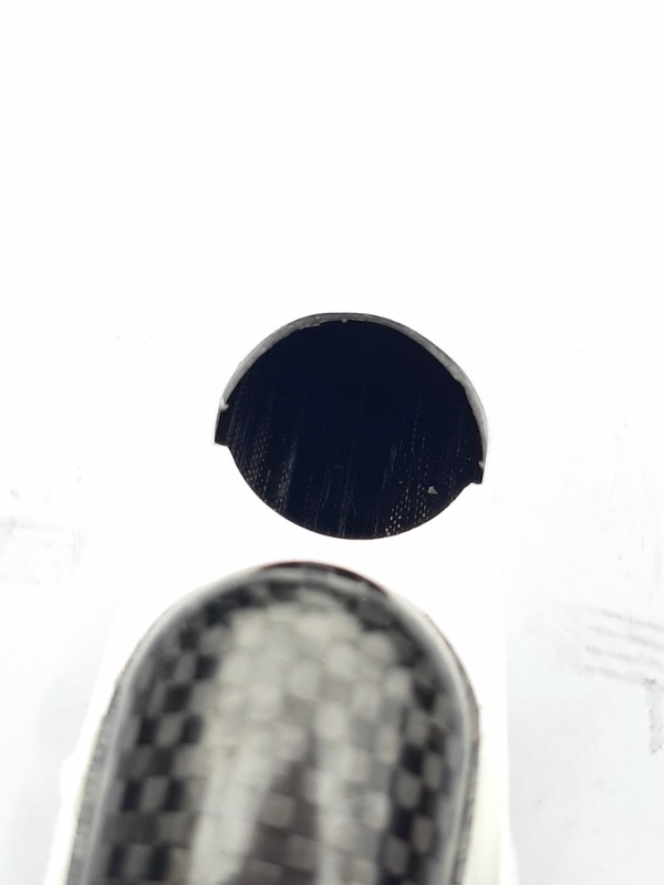

Bailing / Scuppers
Flex – 4/10
Stock SFS – 5/10
Modified SFS – 9/10
The flex bailer system is total junk. Kai did suuuuch a good job with the rest of this boat that the bailer really stick out as a low point on it. It’s a single bailer that goes to a horizontal tube that runs rearward about 6” before it exists the hull. You need a lot of speed (>5mph for sure) to bail. Also, the bucket is SO wet that this boats needs a 10/10 bailing
system. I am contemplating drilling my own holes and adding 2 fenn style venture bailers with bullets to the mid-cockpit. Nothing about it works. The minimum bailing speed is too high, the venturi cone is shallow which does not generate as much negative pressure on the back side, there is no bullet which increases the minimum bailing speed, the outlet area is both too large and too small – its so large that it requires high speed to generate adequate negative pressure to bail, but at the same time its too small in the sense that 2x venturi bailers with bullets would have more cross sectional surface area to bail but the bullets produce adequate negative pressure to bail at low speed (4mph).
The stock Fenn dual venturi’s weren’t much better – the scupper holes were small and lacked bullets. They also needed about 6mph to suck air which is not good. I have most of the same gripes with them as well.
So I opened up the SFS holes from about 0.5”/13mm to about 1”/25mm diameter and added 2 stellar bullets. With the large holes and dual bullets they bail rather quickly. I was able to empty a full bucket of water in 13 strokes with the assist of a wave, or about 30 strokes on flat water.  Although the original score of the Flex vs SFS is only 1 point different, it will be much, much harder to modify the Flex’s bailing system like i did with the SFS. The fenn was easy – Sand holes larger with a dremel, epoxy seal new larger holes, epoxy on bullets, done.
The Flex will require open-hull surgery to fix its bailing issue. One of the crew with a Flex had a Epic bailer installed. It resulted in a big patch and significantly harming the flawless aesthetics.
Kai, if you read this, please just go with Dual Venturi’s with about 1” diameter holes and dual bullets. This is the most efficient bailing system around IME. A dry footwell is not why you paddle ski. Live with wet feet when you’re stopped. It’s a fact of ski.
The extremely wet ride plus poor bailing almost completely negates the light weight of the hull, because you’re carrying around 1 gallon / 4L of water at all times on a downwind. Now my 20lb flex is 28lbs because it doesn’t
adequately bail…this is the biggest black mark on this boat by far. I know Kai is improving it, but please just go with the tried and true dual venturis straight thru the hull with big scupper holes and bullets.

Both these SS's are stupid fun, solid performers in flats will surf mosquito farts with ease.
I added these to both a Vega and Flex, cockpit drains in less than a minute and can hear it sucking bone dry around 6mph. Definitely worth it!!!!

4 years 10 months ago #38817 by MCImes
Venice, I PM'd you. Check your private messages.
Also, is this the set you installed? somebeachoutfitters.com/product/stellar-...-venturi-bullet-set/
Last, how did you remove the existing venturi cone? Does it come off or do you need to cut/sand it off?

4 years 10 months ago #38820 by venicebum
McImes,
Yup, that's it.
I used a Dremel to round out the bow side, put in 1/2" pvc to form a round drain area and back filled everything with WM repair. After that dried the pvc pulled out pretty easy and formed a nice round drain area. The part that has the screw and slides I sanded so it was under the hull height so doing that took a big part of area to be filled with WM.
I used marine silicone, so I could remove after testing, to test the different drain iterations and hood placement behind the bullet.
Hope that helps.
