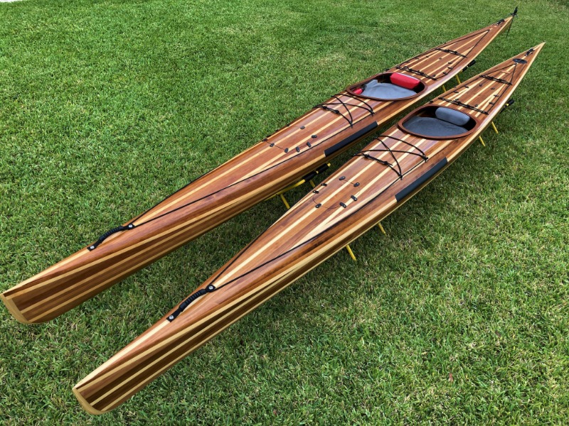

6 years 8 hours ago - 6 years 8 hours ago #36963 by mcnye1
Yes, that is an exceptional article.  For those not familiar with the author, Nick Schade is one of the best and most prolific designers for the home built market.  He was a US Navy engineer before moving into building/designing kayaks full time so unlike most, he has a very technical approach.  One of the things that I like about Nick's work is that he provides detailed drag and stability curves for all of his designs, which allows for an objective comparison of boats.  This is something that I wish that the commercial surfski/kayak companies would do.  I have built two of Nick's designs and they are quite competitive in their respective classes.  The boat in front is a Yukon (18'x20.5") and the back boat is a Mystery (20'x20").  The Yukon races in the USCA SK Class and is faster than a V8.  The Mystery races in the Touring Class under USCA and is faster than a V8Pro and equal to the V10 Sport.
