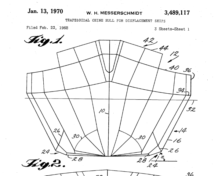

Probably something like this
(Source patents.google.com/patent/US3489117A/en )
Although I cant think of any skis that have this extreme of a trapezoid shape. Trainer K1's sort of have that shape, right?

It is actually the top end super tippy boats that have the 'trapezoidal' shape.
I asked somewhere else, and the best guess is that it is nearly vertical sides (on a very skinny boat) with a relatively flat bottom. So similar to the drawing McImes posted, just extreme slim proportions.  These are boats with a max width of 38cm.
So the max width is at the cockit, they taper from there to the ends.
