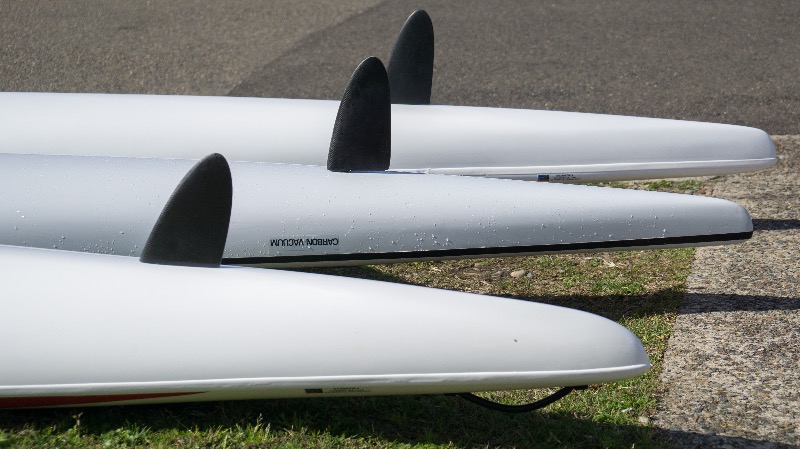

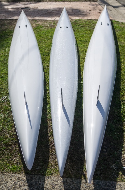

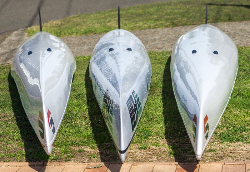

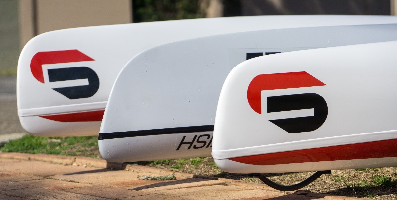

7 years 2 weeks ago - 7 years 2 weeks ago #34599 by Ronbo
I've owned both and really like both (hybrid for both).  I'm 90kg with intermediate (at best) balance.  My view is that the Zest is a little faster and catches runs a little easier.  No free lunch though, as it's also a bit less stable.  I would call it a little more advanced than the Swordy, but much less advanced than an Elite.  I've found both really comfortable and easy to remount.  The Zest is also higher volume ski the bucket is slightly wider.
Here are some photos of the Zest, Swordy (this photo not the "S" version, so rudder placement would be different), and Boost laying next to each other.

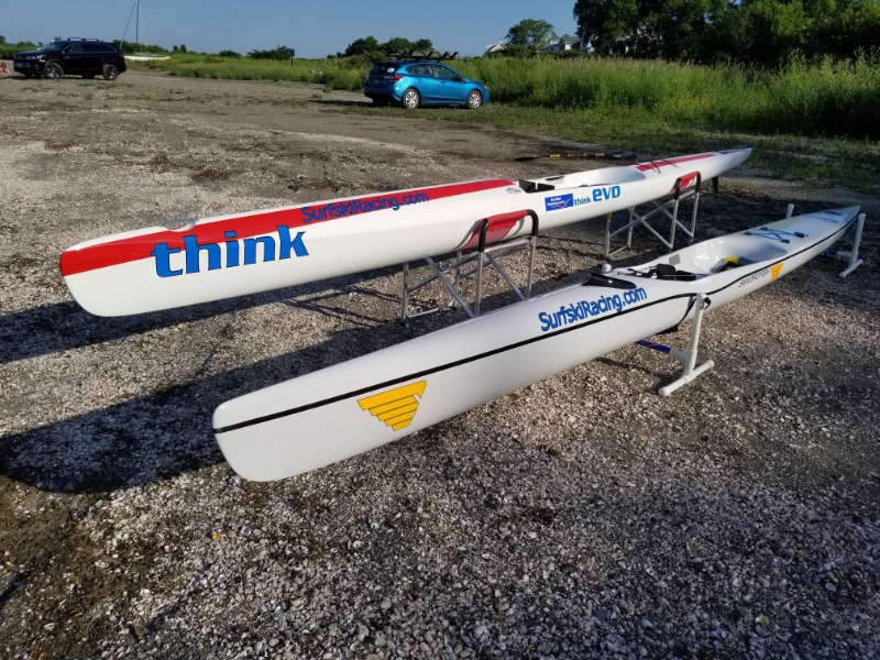

7 years 2 weeks ago #34601 by [email protected]
Also owned both, as well as the Think Evo II.
In fact I went from the Zest to the Evo II to the Swordfish S.
At 80kg, paddling primarily downwind, I find the Swordfish S has just the right volume.  The nose shape means that I don't get flung sideways going upwind in waves.  The nose dips just a touch more than the Zest/Evo II but not so much that it bothers me, although I have a wave deflector installed.
The Swordfish S is perceptibly more stable than the other two.  I paddled both the other boats long term and liked them, but right now the SF is the boat for me.  Stable, nimble, easy to remount.  All good.  My two fastest Miller's Runs were both on the SF.
The following user(s) said Thank You: Rod Thomas
