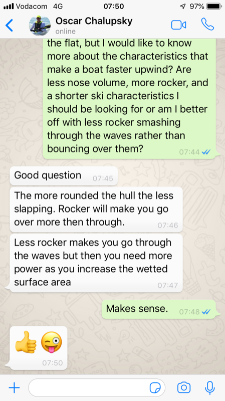

The reality of where I race is that a lot of the events have a significant upwind component – often into some wind chop that really kills the boat run with the hull slamming down on the other side of waves. We hear a lot about what makes a ski fast downwind or on the flat, but I would like to know more about the characteristics that make a boat faster upwind? Are less nose volume, more rocker, and a shorter ski characteristics I should be looking for or am I better off with less rocker smashing through the waves rather than bouncing over them?
7 years 4 months ago #33638 by [email protected]
From Oscar Chalupsky:

Oscar's input about the rounded hull slapping less is interesting, I have found the opposite.  The boats that slap the most for me have a rounded hull up front- G1 V12 and the original Uno.  The same holds true in the team canoes- the old school OC6's like Bradley Lightning and Mirage have rounded hulls in the bow and they are terrible upwind compared to the unlimited boats with sharper cross sections up front.

My impression was that when Chalupsky said round would slap less he meant round as in less flat, not less vee.
