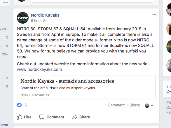

8 years 8 months ago #30054 by owenfromwales
Indeed Mark, check out this post I just found in my FB feed:
www.facebook.com/NordicKayaks/?hc_ref=AR...lknLRFclztCc&fref=nf
Great to see new skis coming out and also makers keeping us informed of changes :-)

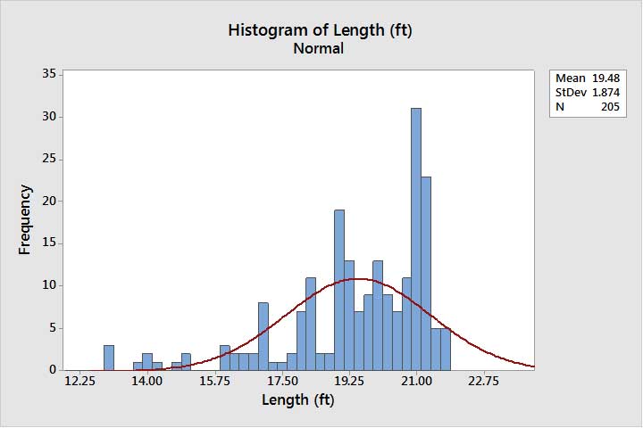

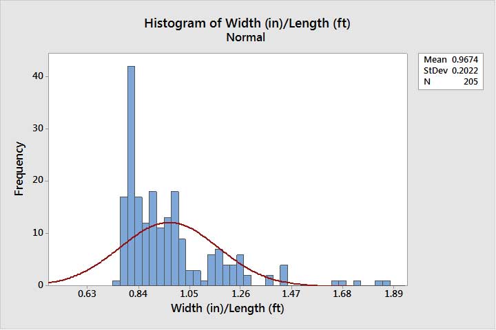

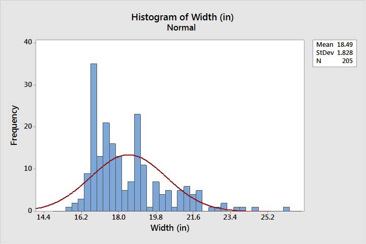

8 years 6 months ago #30329 by Wombat661
Replied by Wombat661 on topic Surfski Width x Length Chart - Sept. 2017
Owen,
Thanks for the chart. It is just begging for a statistical analysis :)
Here it is:
These are histograms that shows how many boats are available for each length. Bell curve is calculated.
For length, you can almost see a double hump. Two popular size, 19' and 21'
For the width, popular size is about 16.5". That is a one sided bell curve. Number of boats less that 16.5" drops off quickly. Looks like 16.5" is as narrow as practical.
The width divided by length chart. .8 seems to be a popular ratio. That correlates to 16.5"/21' boats.
8 years 6 months ago #30330 by owenfromwales
Cheers Wombat - good work! :)

8 years 2 months ago - 7 years 10 months ago #31060 by owenfromwales
In 2013 there were about 50 ski designs on the list, today (March 2018) it`s up to 222 and there must a few more out there that are absent. Feel free to let me know what`s wrong with/missing from the list.
Happy paddling all!
Owen

7 years 4 months ago #33312 by owenfromwales
In 2013 there were about 50 ski designs on the list, today (January 4th, 2019) it`s up to 235 and there must a few more out there that are absent. Feel free to let me know what`s wrong with/missing from the list.
Happy paddling all!
Owen
(present set up: Stellar SEI 2G in Advantage lay-up, and Knysna Racing Delta L paddle.)
