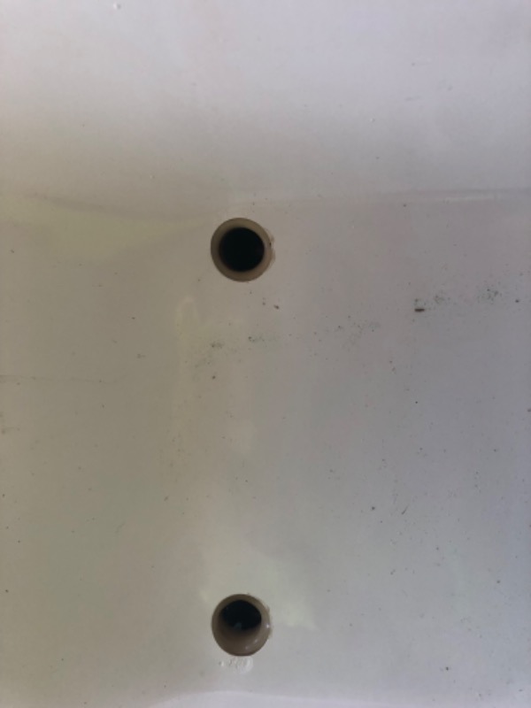

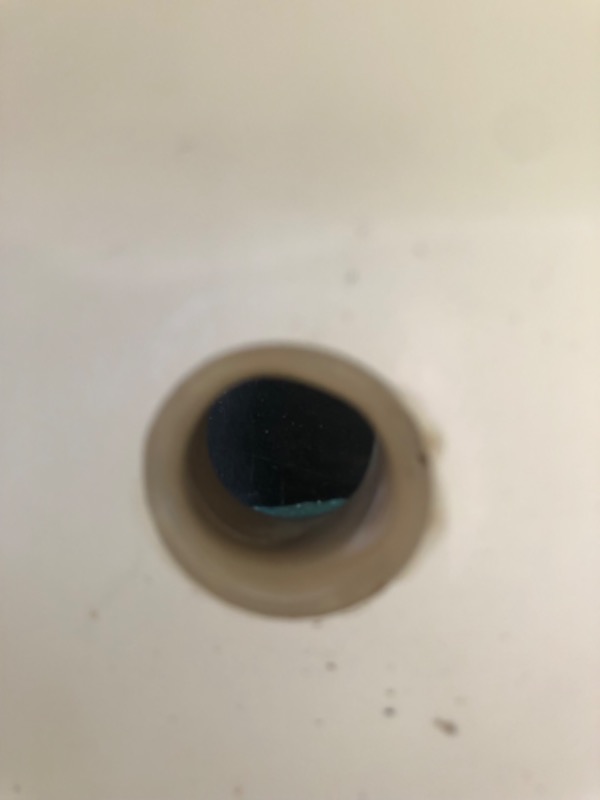

9 months 2 weeks ago #41352 by mickeyA
Replied by mickeyA on topic Bailers
How do I fix a Fenn bailer? Exactly where the white (gel coat) meets the tan (through hull tube), is where water is getting into hull. It could also be on bottom, but there is a cone shaped cover (bullet) over it. I sprayed soapy water on it and gently blew into hull and bubbles are coming out right at the color change. Learned that trick from Ranga. I think I also recall putting a watery adhesive around the area and sucking air out of hull is one way to seal it. If so, what product is best? Do I put only a small amount around the seem, or do I seal the whole circle, including some of the tube? Thanks.
9 months 2 weeks ago #41353 by zachhandler
Replied by zachhandler on topic Bailers
@MCImes can you give some advice? I believe you had the same problem.
9 months 1 week ago #41363 by mickeyA
I think I will tape off a circle around the scupper hole, creating an apron around it of ~1cm, then use JB Weld inside the tape and about half way down into the hole as best I can (toothpick or similar). I will suck some air out in hopes of getting the solution to enter into the cause of the leak. Even if I cannot pull any weld inside the crack, it should be sealed off. Thanks

2 months 3 weeks ago #41431 by mickeyA
How do you remove venturi covers/cones? Will prying off damage gelcoat? Can you reuse them? Any specific bonding product best to reattach?
After using JB Weld on top of bailer cylinder, which closed off that leak, it is still taking on water from the bottom of the bailer cylinder, thus the need to attack it from the bottom. Cones are in my way.
