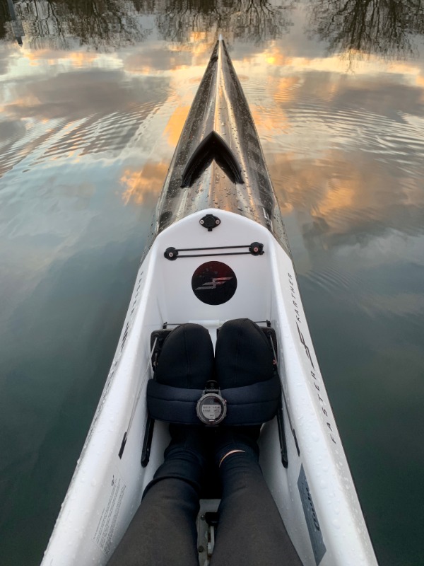

6 years 8 months ago #35401 by Cryder
Pic is a little bit dark, but this is what I could find.

6 years 8 months ago #35402 by waverider
So the neoprene is like a sleeve that slips over the existing footstrap? If so does it make it difficult to adjust the strap?

6 years 8 months ago #35406 by wruthrauff
Thanks for this suggestion. I've been using a Garmin Forerunner 220 just as you've shown in the picture.  It works fine that way on my Epic foot strap.  But that GPS is a cheapie model and doesn't work with my HRM - hence I'm considering upgrading to a different GPS.
