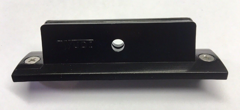

What are way of permanently fixing a race number holder to a ski? It came with nut and bolt for a Kayak that for obvious reasons won't work with a ski. Glue and screw? Is any type of screw recommended and/or glue?

I've just used outdoor double-sided foam mounting tape, - (the same stuff they use for mounting badges on cars) for both skis and K1s. Available from Bunnings or auto accessory shops.
Once mounted, it won't come off unless you want it to - and even then you'll need to use dental floss and alcohol to remove it.

I use a number holder with two suction cups that I bought online from ProKayaks in Narrabeen. However, many of the skis in the Pacific Coast Paddle Series use a piece of pool noodle cut in half longitudinally. The flat side goes on the deck and a slot is cut in the curved side for the number. Sometimes duct tape is used to make sure the number stays put and the noodle is held in place by the deck rigging. Because the Stellars have such a high peaked foredeck I have seen blokes just tape the number to the side of the deck visible to the judges.

5 minute epoxy. sand the deck and holder first. 5 minute epoxy melts at 65 degrees C so you use a heat gun to remove it....gently.

I opted for a strong double sided tape. Not sure Hercules could get it off. Time will tell though.

Simple... Epoxy glue/resin.
