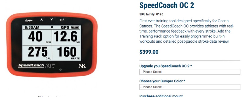

SamTaylor cheers for info on Speedcoach GPS. Certainly has the bells and whistles for a GPS specific unit for paddling though at AU$500 not cheap. Mind you if chasing just that, reckon I would invest in one.
Thanks.

I second the recommendation for the NK Speedcoach. Been using it routinely for 2 yrs now and not even a hiccup. If I lost it, I'd buy another. Current speed updates almost instantaneously and much faster than on my older 310XT - which sits in a drawer now. Stroke rate is the default screen in the upper left box (mine was made for SUP's) and I don't find that useful. The other three boxes are changeable. Battery life is about 10 hrs or so until it needs a recharge. I've only downloaded data to a laptop once, and it was easy. I don't use the programmable workout function.

I found the Velocitek Prostart, which looks nice, but at $599 and less features than the Speed Coach I think the Speed Coach looks a little more appealing.
