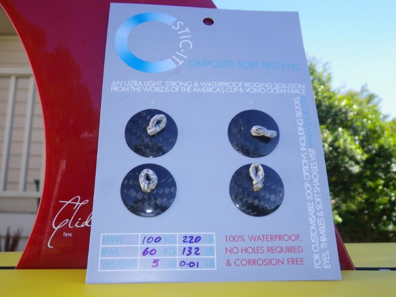

Hi Surfski forum!
My name is Ross Lefrank, I'm a 31 year old avid SUP'er from Adelaide, I found your team through a friend who paddles surf ski's in Sydney.
I have developed a product from my experience in the America's Cup and high end yacht racing industry that I think will transfer well to the SUP, Kayak, surf ski world for cruising, downwind paddling, touring and racing.
Basically what I have developed is a small low profile carbon disc with a small strong rope loop through the middle that when adhered to a board/kayak, with either an epoxy or sikaflex type product, it can have a variety of uses. I have sold a bunch to the US and Europe for people to use as a criss crossing bunjee lashing system on the front of their SUP boards to store things like life jackets, drink bottles etc. I also feel it may lend well as a safety system for gopro's, extra or replacing existing leg rope plugs and many other uses. There are also a few guys in Victoria and NSW trialling them on theirs SUP's and kayaks.
Having only limited knowledge of high performance kayak's and surf ski's I have seen at least one use for a product like the one I'm producing. This was to replace the standard bolt in eye for a bunjee lashing between foot pedals that helped the rudder centre automatically. Replacing this with one of my soft pad eyes would mean no holes, bolts and hence no leaks! As well as this I figure for touring etc it would be handy to be able to store a dry bag, drink bottle, spray jacket etc which I know some brands don't offer.
My soft pad eyes are super strong (managing to hold over 100kg when stuck with the right glues), require no holes to be drilled in your board/kayak, have a low profile look (no stubbing your toes) and are super light (weighing around 6g each).
These come in 2 sizes at the moment, 25mm and 40mm diameters with the larger having a greater working load.
Check out my website, www.stic-it.com, I can send you some more pictures if you would like (as my website is still under construction). Also one of my customers has started a forum thread which may help shed some light www.seabreeze.com.au/forums/Stand-Up-Pad...ots-on-my-new-board/
I have also developed a way of retrofitting a surf life saving style handle to a board. This works by using my larger 40mm pad eye with a bolt that taps into the centre of the pad eye. The handle will be easily removed and all you will be left with is a round carbon disc with a 4-5mm wide hole in the top. The bolt only goes into the disc, so there would be no holes at all in your board. This same soft pad eye can be used for mounting just about anything that requires a bolt, previous customers have used them to mount navigational lights and bike drink bottle cages.
I have used the same disc but with a different thread pattern to attach a tripod mount for a go-pro which in my opinion is a lot safer.
Im looking to get a few more kayak/sufr ski guys out and using my products and would be interested in any feedback you could give me. If you or anyone you would know would be interested in using my soft pad eyes please don't hesitate to get in contact with me.
I look forward to hearing from you
Cheers!

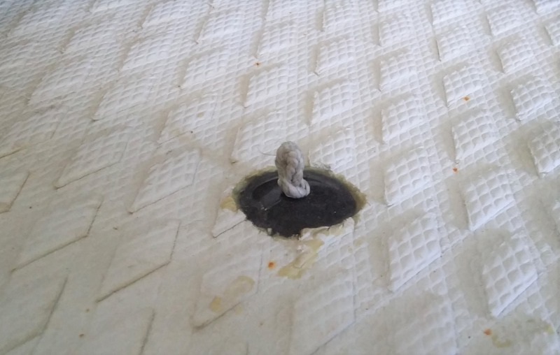

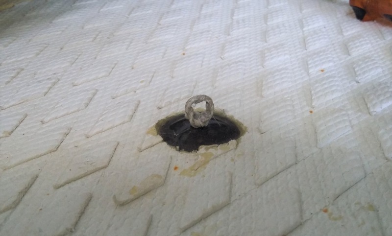

7 years 3 months ago - 7 years 3 months ago #33839 by paddlepop
i got mine direct from Ross when they first came out and they are in as new condition except for fading of the dyneema line or whatever it is.  so that's 4 or 5 years use on my sup.  i just put them on with full strength epoxy not the 5 minute stuff.  i went for the smallest loop so as not to feel them being stepped on when i'm surfing/paddling.  with hindsight i would go with the next loop size up.  as you can see they close up if you don't use them for a while and need to be opened with a phillips head screwdriver or a pencil etc.  a bit of a pain when i'm keen to hit the water.  they're positioned on my sup so i can attach shock cord lines to hold down my storage seat.  a great product
hope this helps.....Pete
