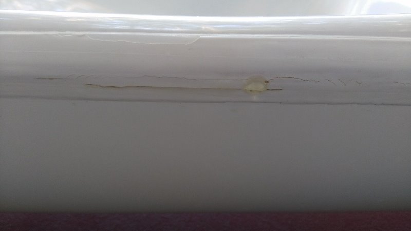

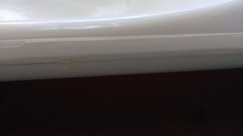

Hello,
I bought a second hand Epic v10 Sport 2 weeks ago, but already it has problems. It's leaking because the taped seam has some cracks. Looks like it's has already been badly repaired with a tape and repainted without even sandpaper it. Rusty water is leaking. There are no shop for repair composite kayak in my area so I have taken it to a boat repair shop. Clearly they never have seen a surfsky before (me too), but they proposed to remove completely the seam and replace it.
Well, I no have idea if it's a easy or impossible work, I am a bit scared because they are used to work on much ticker hulls.
I would like to have your opinion
Thank you.
I know I look like a dumb, but I wished so much to have a surfski that I didn't checked too much (at all) when I bought it

Yes the whole seam is taped and it's leaking just in a few places, but when I bought it was perfect. All this disaster happened just in a few times in water so I think things can go much worse after some more use.
You reassured me about the relative easiness of this work and I think it's a good idea to take the whole seam off and separate hull and deck to check what is so rusty inside and reinforce the anchor points or the rudder pedals.

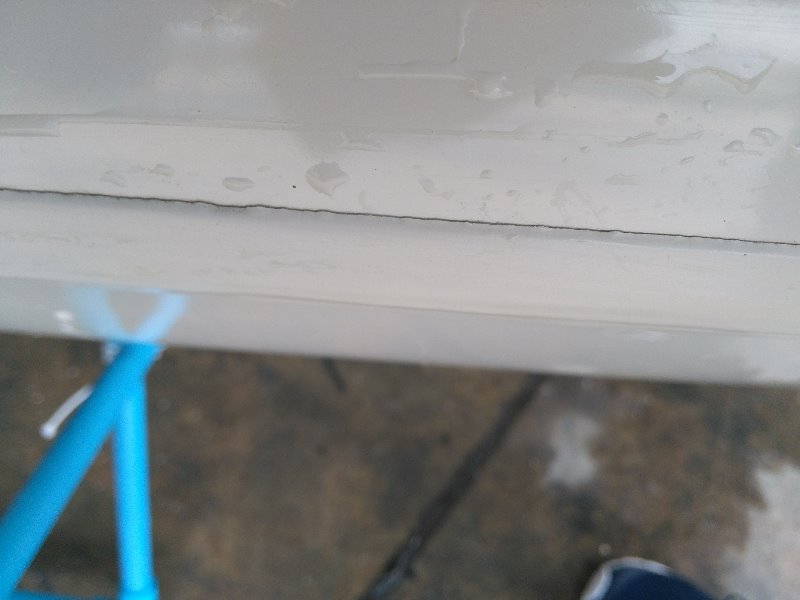

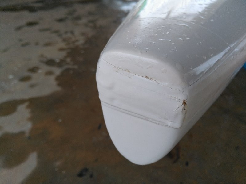

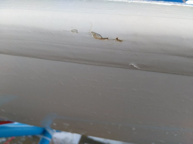

In the 2 images attached you can see how the paint over the seal is flaking
and the seal itself is slightly detached. Rust is leaking from there too.
9 years 2 months ago #28782 by Ranga
Replied by Ranga on topic [help] leaking seam
I do this for a living and if you want to remove the whole seam you would make someone rich for no reason. You cannot take the deck off from the hull without serious damage to the ski and a lot of cost. In fact more than what you paid for it in the first place, even if you bought it new.
As I have stated before the patches were poorly done, redo them only, the rusty colour is the water coming from the outside, not inside, there is nothing in the ski that would cause the dark colour water.
I doubt the ski even takes on water from pictures I can see. Does water run out of those areas?
One easy way to check is to put a 2 litres of water in the ski and see where it comes out, just swish it around and check where the water is running out.
Unless you paddle with the seam under water there should be no water coming in as the seam is above the water, paddling on flat water that is.
There are other possible areas where water is coming in like the rudder post and the ventury.

yes water is going out from those cracks, here the boat stand on one side, a drop is leaking
and the rust is coming from the ski, I removed the screws, they were rusty. Every time there is water inside, maybe yes is coming from the rudder or the venturi. I paddle at sea, so the seam is often underwater, but me too I don't think water could enter from those cracks.

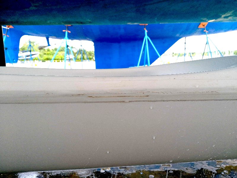

hi, next Monday they will start to work at it, meanwhile we have started to check the seam. the previous repair turned out to be just a 1 cm wide fabric tape, like a plaster, covered by gelcoat. the gelcoat was applied without sanding, I can easily take it out with my nails
I was surprised to see the gap between hull and deck, it's 2-3 mm , it's normal?
Monday they start to sand and apply a fiberglass seam, 2-3 meter at a time.
the removed 1cm plaster
2-3mm gap
while staying in the shipyard many small bubbles (1mm diameter) appeared on the foredeck, I suppose they worked with a spray solvent nearby

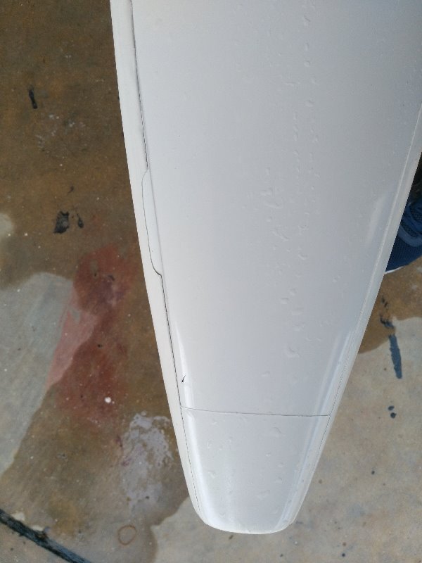

9 years 3 weeks ago #29008 by matteo
Replied by matteo on topic [help] leaking seam
hi Ranga
They have made the work: Removed all the old patches, filled the gap between hull and deck with epoxy, then a fiberglass seal , finish with gelcoat on the new seal.
The work is not bad, just the bill is impressive in my opinion: 800 euro.
If I can ask an opinion about this bill, isn't it too high?
