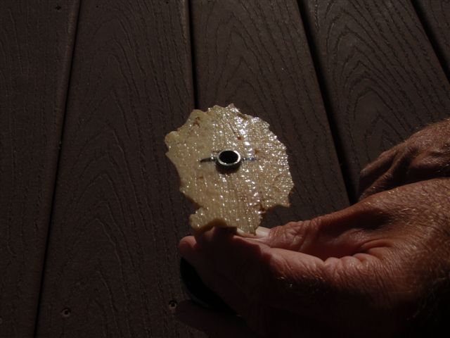

:dry: Been paddling a legend for about a year here in Socal. Love the comfortable bucket. Love the stability and surfability of this ski in conditions. Have been in6-8ft ground swell with 25 kts. plus wind with bump on top so not the huge conditions but plenty of action. Ski catches runs well and I like the hard chines bite on a bump. Flat water spped is fine ,prahps a bit slower than V-10 , Mako 6. BUT and this is big , the warrenty/mfg. support SUCKS. Without boring you with excess details , think did not even come close to standing behind a mfg. issue with the rudder assembly. I havee some pictures to demonstate the problem .Anyway love the way the boat performs , be sure you assess the blob of epoxy that is all that anchors the bottem of the rudder post tube to the hull (unfortunately you would have to cut a hole through the bridle box to do this and thats where you would go to fix it anyway. I personally wouldn't paddle a think boat in conditions without beefing this up. BTW this is the second think boat I have had with this problem. Think warrenty covered the first one and claimed I "broke" the second one , go figure.
16 years 3 months ago #4165 by Sandy
:ohmy: Here are the pics , note the shine indicating the lack of bonding of the blob to the hull surface
