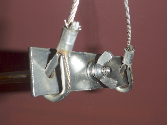

MickeyA:  It sounds like a couple things going on.  First, the rudder lines shouldn't be able to work around the yoke, regardless of the tension in the cables.  It may be that the thimbles (U-shaped protectors) are too big, the cables are crimped with too much slack, or the yoke is too small.  I attached a pic of a typical Fenn setup, and it may illustrate how those thimbles shouldn't be able to wrap around the yoke.  (Rudder and cables are rotated out of their normal relationship for the photo.)  Unfortunately, whatever is going with your setup is difficult to fix.  Yoke, thimble, and cable tension changes require un-crimping and re-crimping, which is tough without special tools.  However, as you suggest, you might be able to sort it out by tensioning the cables from the pedals.  Either shortening the elastic, installing thicker elastic, or re-routing the elastic may help.   Another idea that may work is to install a "stopper" in the rudder well that keeps the yoke from over-rotating.  If you look in an Epic rudder well (and some other brands) you should see a molded-in stopper.  You could glue in a piece of material to achieve the same effect, and that may help.
Good luck!
Don

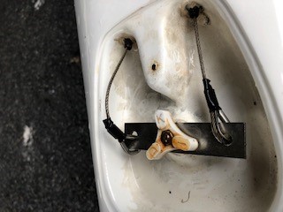

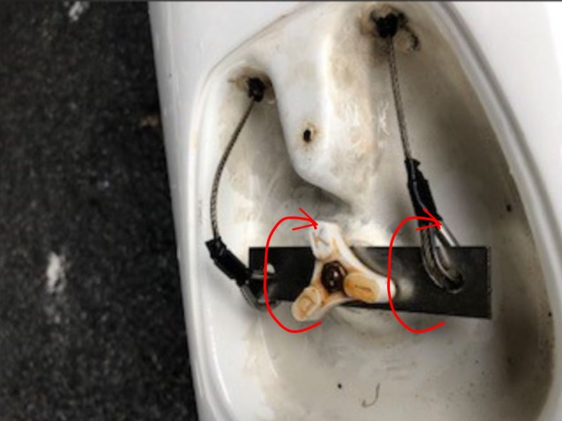

thanks!  so it does appear as though  my thimbles are too big.  The irritating thing is this is directly from the Fenn factory.  I bought it new 2 yrs ago and have not touched it, other than changing the rudder to DK.  See my picture, it shows one side flipping around to the back side of the yoke, which is disaster when on water.  The cover requires a screwdriver, so if this happened way out, I would have to jump out, find a screwdriver, unscrew the cap, and pull the thimble back to correct side.  That's not happening.

5 years 8 months ago - 5 years 8 months ago #37552 by mickeyA
i do not think my picture uploaded.  my first time to include pic here.  hopefully this comes through...

5 years 8 months ago #37556 by waterbornewarrior
The picture is really small, but it appears to be a normal Fenn setup.  But your cable is clearly able to rotate around the side of the yoke.  The well has the "stopper" shape that keeps the yoke from over-rotating, so it's not that.  Your ideas of extensions on the yoke, and tape / tightening around the cable thimble, seem promising.  And as we've both mentioned, tensioning at the pedal end.

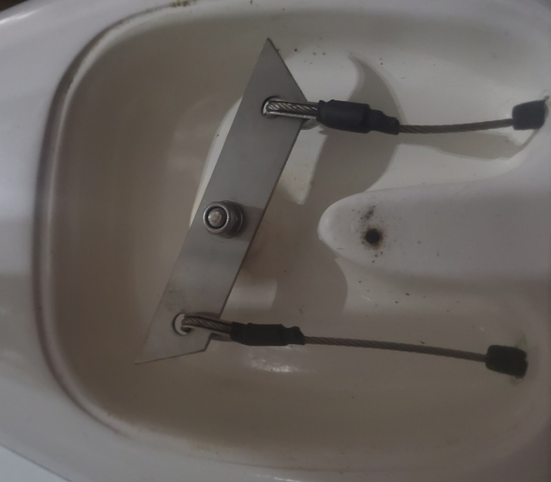

The new bar fixes it, you've got one of the old bars.

I have that new shaped bar and still have the twisting problem on one side.

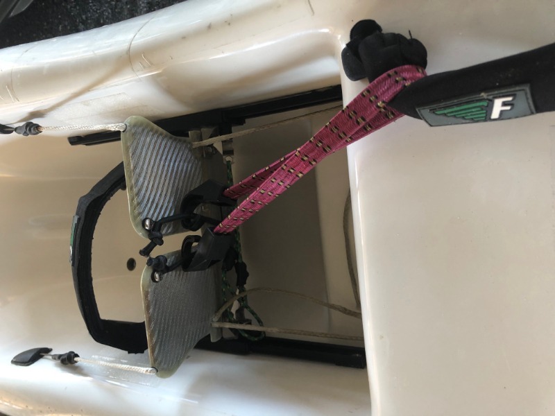

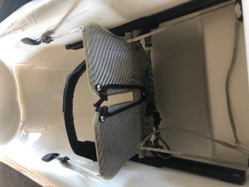

Great replies!  I did rotate the bar to somewhat alleviate the twist, even flipped it again to see if it would help more.  The good side did not seem to care how many times I flipped it, it stayed straight.  This is b/c no matter how many times I twist from the back, the front rolls with it.  The front is not anchored or continuous, it is just attached to a rope.  The real problem seems to be the bad side (left on my pic) does not push back through the tube on its own.  It has to be pulled from the front (bungee or foot pressure).  I can take all pedal pressure off (no bungee) and move the rudder around back and forth (on dry land) and the good cable always go straight back into tube, while bad cable does not want to go back into tube.  Presumably b/c it is permanently kinked.  If it were just twisted, it would unwind itself up front.  I am not sure how it got kinked, but I've got to do something.  I know I can always re-cable it, but I never have fun with cutting wire and thimble, reconnecting to rope (shrink wrap needed), getting length just right, etc.  I'm just not good at and do not have the right tools.
I will first try to add a bungee system.  The bungee setup it came with from shop (only 2+yrs old) is not good, imo.  see picture for poor design, imo.  and the temporary bungee fix using the side handle..
