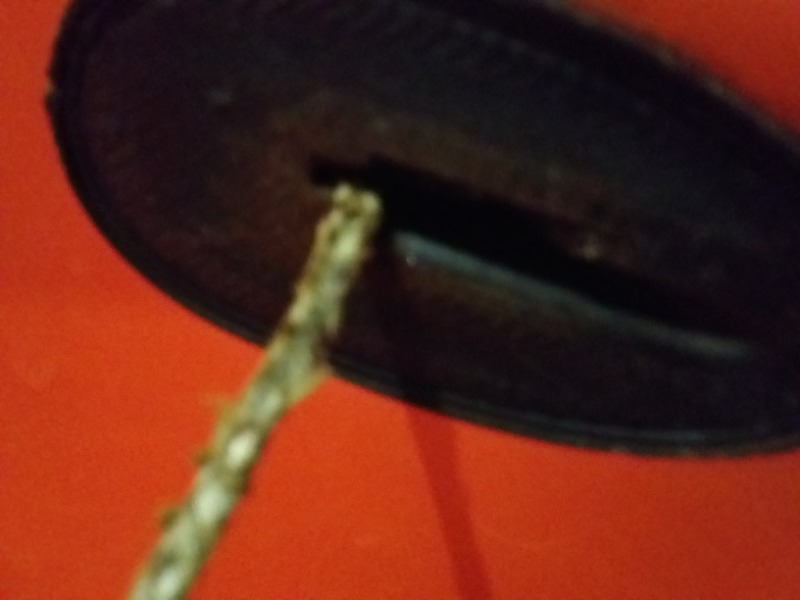

Hoping someone can offer some advice on how to deal with a rudder cable fraying on a 550. The cable appears to rub just a few centietres into the ski in the cockpit where the cable enters the black plastic. is this common? can the plastic be removed to check?

Yes it is rubbing against something inside the ski. I was wondering if the tube is disconnected and the edge is cutting into the cable. It has always been like this and I have moved it forawrd once and cut off the frayed section.
I can feel it when I apply pressure to the pedal.
cheers

I will need to remove the black plastic to see what is going on. It is becoming more difficult to push the pedal.
If anyone know how to remove the plastic I would be grateful.

I have tried that flushing the tube but it hasn't helped unfortunately. I think the only way to go is to remove the black plastic piece to see what is going on. I have asked Nelo to suggest a repair shop some time ago but have not received any answer.
