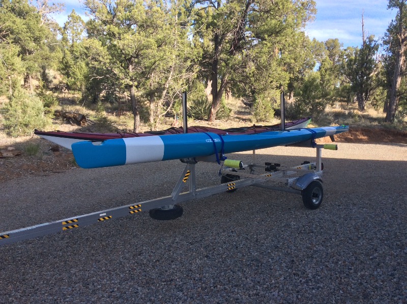

Pic attached of the trailer I use now, which is bolted together from a kit. This one does have the advantage of allowing a LOOONG crossbar spread. The 77” I set it at is the shortest span it allows. It is designed to allow carrying a double sea kayak or other long boats—nice spread for surf skis. Payload is a paltry 350 lbs, which won’t matter for hauling two kayaks or surf skis. It comes stock with a coupler for a 1 7/8” ball, so I ordered it made with one for the more common 2” ball. Typical not-so-wonderful exposed wiring bundle, flimsy taillights (the ones shown are a different replacement set), and flexy plastic fenders that will crack from flexing at the weird attachment points. I had to juryrig a fix for the latter and am working on a way to better attach the new fenders when they arrive. But it has worked very well for carrying the boats on normal roads (not rutty or rocky tracks).
Please note that the strapping shown in the photo was only for keeping wind from blowing the ski off while parked. When I haul it, I wrap the straps completely around the ski one time each. 12’ straps provide plenty of length to do this. The trailer is 18’3” long total.

5 years 10 months ago #37176 by mcnye1
Replied by mcnye1 on topic Ski trailer?

5 years 10 months ago #37179 by mcnye1
Paddlepop - Thanks again for the compliments on the boats.
This trailer can be shortened.  I installed Malone's optional kit that makes the tongue of the trailer removable.  If you look closely at the picture below, you will see a pin where the tongue goes into the trailer frame.  If you pull that pin and disconnect a wiring couple, the tongue slides forward out of the frame.  This allows the trailer to be stored upright leaning against a wall.  You can also shorten the trailer by sliding the tongue back into the trailer.  If you look just above the black wheel on the tongue stand, you can see an alternate pin hole which would make the trailer very short.  I never tow with it that short, but that is how I shorten the trailer for storage.  Obviously, you could drill another hole in the middle to make the trailer 1/2 length if desired.
