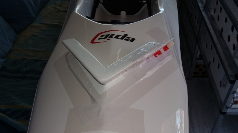

Excellent description Zach. I taped it on about 18" in front of the cockpit last night but was unable to test it due to very flat conditions. Sunday is forecast to have 20kt winds though.

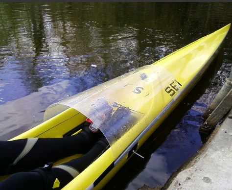

Similar to the v12 foreskin, has anyone ever made a custom carbon shroud that covers from the front of the cockpit to around the footstrap? As a weekend project I was thinking of taking plastic sheeting, matching the profile of the deck-to-cockpit transition area and using it as a mold to glass over with carbon. basically like the picture but in single layer carbon and shorter height and length wise (maybe half the size of the one pictured). The SF does not get much water over the sides when a wave crest passes underneath you, but some gets in and it happens at the front of the bucket by my feet. I figure a small shroud would prevent 50% of the water from entering and make the SF an extremely dry ride on steep days
