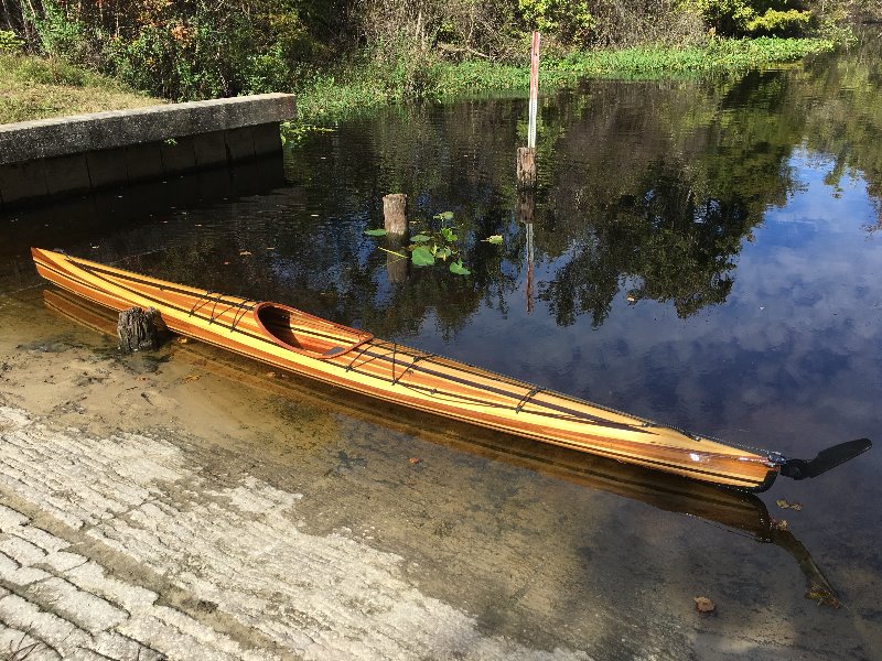

+1 for Topender's recommendation regarding an SEI in the Multi-Sport layup.  I have an SEI in the Excel layup that I use heavily for racing/training in Florida Rivers.  I love the boat but have to be really cautious regarding obstructions.  I recently bought a Stellar Rapid-S in Multi-Sport and find that layup much better suited for waters with underwater obstructions.  The Rapid-S may be worth your consideration if you have the skill to keep it upright.
You never did say how long your races are.  If they are multi-day unsupported events where you must carry all of your water & food, plus camping/safety gear, you will pretty much need a kayak.  It is hard to get more than about one day's worth of water on a ski.  You may consider the Stellar S18R.
I would also suggest a thorough study of the rules for the races that you are interested in.  Here in the US the adventure races have significant safety gear requirements which basically force you to paddle a kayak.  Also check to see if there are any boat classification systems.  Make sure that the boat you choose is not the very slowest in the division that you will be competing in.  Lastly, looks at the results from the las several years and see what the winners have been paddling,
I greatly appreciate SpaceSputnik's discussion regarding the differences between kayaks and skis.  I would respectfully submit that his discussion is based on the more traditional low volume/Greenland Style Sea Kayaks.  There are a number of kayaks out there that are designed for racing which could be called Fast Sea Kayaks.  The S18R, Epic 18x and QCC700 are examples.  Generally speaking, these boats have surfski style footbraces with raised front decks and large cockpits to allow for good leg drive.  They have hatches for gear storage and tend to be more stable than similar skis because of lower seating.  The lower seating also gives you a lot more options when it comes to adding padding for comfort on very long races.  In rough weather you can wear a skirt but you won't need one for most river conditions.  I have a Wahoo FSK (18.5' x 20.5") which I have been racing for 3+ years.  Speed wise, it is competitive with boats like the V8/V8Pro.  For long races, I find my carved foam seat to be much more comfortable that the bucket of my SEI.  I also have a Nelo raised rotating seat that I use for shorter races because it allows better leg drive.

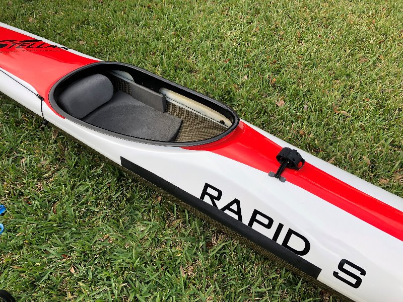

Just after your thoughts on the Rapid S.  Is it much faster than the SEI and what about the stability compared to the SEI given its 4-5cm skinnier?

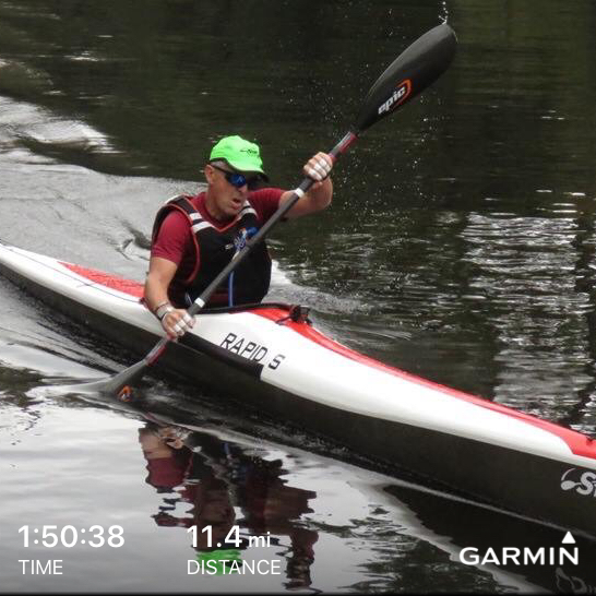

The Rapid-S is a great boat but probably not for everybody and not for all waters.  When I bought it I was looking for something faster than the SEI and better suited for the river paddling/racing that I do.  I paddle in a lot of obstructions and in spite of trying to be careful,  I was beating up my SEI (Excel) pretty bad.  I had previously paddled the SES and SEL but found the SES a bit too unstable and the SEL bucket way too big.  I went with the Rapid-S because it has the same (fast)  hull as the SES but a lower seat which makes it more stable.  After a month or so, I replaced the standard backless bucket type seat with a lower custom carved foam seat.  This improved both stability and comfort.  Even with the new seat, it is not nearly as stable as the SEI but more so than the SES.  Speed wise, I find the Rapid-S about 10-15 seconds per mile faster than my SEI.
The two real big negatives with the RS are boarding and self rescue.  The rather high cockpit makes it a bit challenging to board until you get used to it.  It is very much like getting into an ICF K1.  This is also a boat that you can't re-enter in deep water.  There are no bulkheads so the hull fills with water when you capsize.  There is flotation so the boat won't sink but you have to swim it ashore, pump it out, then reboard.  It is not stable enough to reboard when filled with water.  For this reason, I only paddle this boat in rivers or near shore.
The difficulty reboarding is significantly offset by the lower CG which makes capsize pretty rare.  I have over 270 miles on the boat and have only fallen out twice.  Once was a motor boat wake and the other was when I hit a log with my paddle.  I have a skirt which would have allowed me to right myself in both cases but I don't like wearing it.
For adventure racing, these is some room to pack extra supplies behind the seat but not much.
My Rapid-S has the Multi-Sport layup which means carbon/Kevlar hull and with kick-up rudder.  The boat has held up wonderfully paddling my obstruction laden waters.  I highly recommend it.
You are a bit bigger than I am so you might find the RS a bit tight.  If you are going to go with an elite boat, I would suggest trying either the SEL or SEA in the multi-sport layup.
