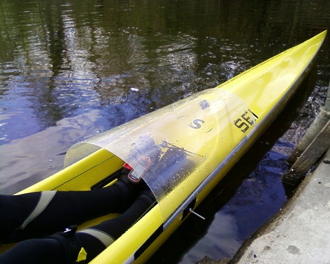

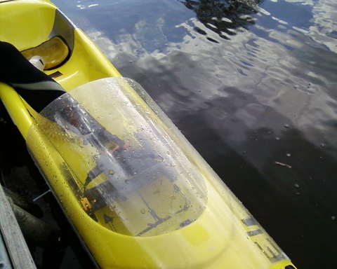

7 years 6 months ago #33273 by M.v.E.
I had the same problem years ago in the winter when I began with surfski paddling. I quickly realized  that the reason for my cold feet was that I constantly dripped icecold water on my toes with my paddleblade.
The solution was quite simple and cheap. I bought a transparent and flexible plastic sheet in the next hardwear store
and attached it with self adhesive velcro over the front section of my surfski cockpit. Since then I never had cold feet
anymore. I wear a drysuit with attached latex/rubber booties and very thick smartwool socks underneath.

7 years 6 months ago #33274 by Wavehugger
That makes perfect sense! Thank you for sharing that wisdom!

7 years 6 months ago #33277 by M.v.E.
Yes, see the attachments below.

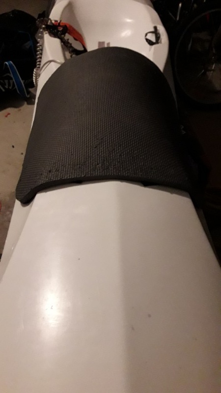

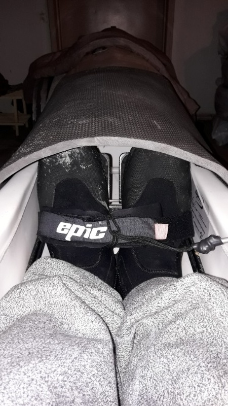

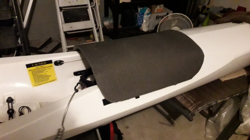

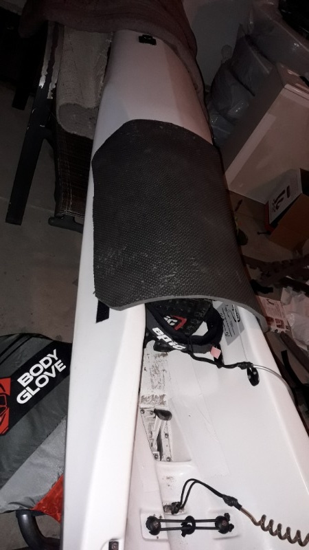

7 years 6 months ago #33291 by SpaceSputnik
An update.
I tried these rubberized 5 mm booties that I had mentioned. They seem a bit better than regular 7mm neoprene boots but still, after about an hour and a half my toes were cold again.
So now I have this concoction sitting in my garage. Basically just a foam tile attached with the meanest velcro I could find. I tried working with an acrylic sheet. While bending that with heat I got a little overzealous and the sheet cracked. I am glad it did because these cracks were nasty. Long and sharp pieces. I sure don't want that anywhere near me on the water.
The foam seems to be pretty secure so far but it remains to be tested.
7 years 6 months ago #33293 by M.v.E.
The transparent plastic cover for my surfski that I pictured in my former post is quite flexible so there was no need to bend it into shape. It´s also not brittle. It takes a lot force to brake it. Unfortunately I do not know  how the material is called. But it seems that you found another solution that works.

7 years 6 months ago #33298 by mamaru
As far as I know it's polycarbonate and about 1 mm thick. Mine came on a roll and you can cut it with a strong scissor, it is quite flexible and will not splinter, even if it takes a hit. With heat you can bend it even sharply, I use it as material for a leaf-/seaweed deflecting device for the bow. Acrylic glass is much more brittle (mine broke in the attempt of making a cover, too). You'll just have to see that your feet and legs have enough room underneath and behind both paddling and upon re-entry.

7 years 6 months ago #33299 by M.v.E.
Yes you´re right with your description. That´s exactly the material I have. It´s really tough and it will last forever.
