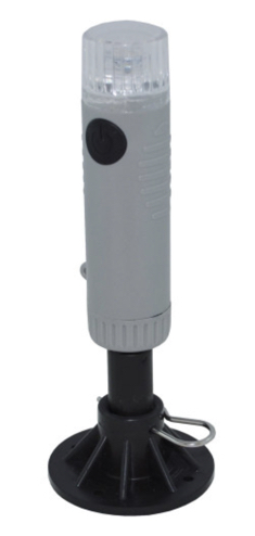

7 years 8 months ago #33075 by [email protected]
I like this one, I mount it on the back deck at night. Haven't used a flashing light.
www.amazon.com/gp/product/B00AR0SE2O/ref...01_s01?ie=UTF8&psc=1
The suction cap is pretty good, but I tape it down with duct tape anyway.

7 years 8 months ago #33083 by Epicpaddler
I use the same light as Robin. In the States it's this one. www.rei.com/product/722830/paddlers-supp...ith-suction-cup-base
It meets the US requirements for kayaking at night. It's bright as long as you don't look at it it won't destroy your night vision. I'd prefer traditional running lights, but this at least allows other vessels to see me. I try to stay out of their path regardless.
7 years 8 months ago - 7 years 8 months ago #33084 by Watto
www.whitworths.com.au/portable-led-stern...suction-screw-mounts
Suction mount included, light just screws into it. I ditch the lower mount above. Constant not flashing however is brilliant. Keep thread lubricated! I leave the suction cap on the boat and just screw in the light when I paddle in the dark. Forget to to keep lubricated (over a summer) and thread rusts up.
Last edit: 7 years 8 months ago by Watto.
