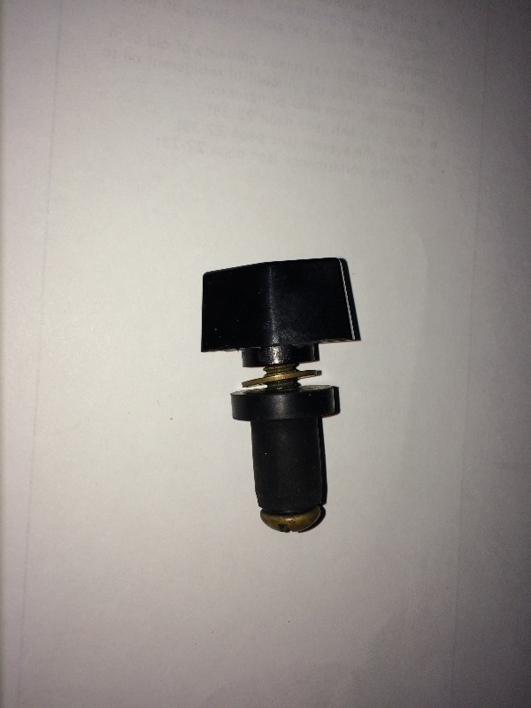

Get a 1/2" rubber "well nut" from Home Depot or big hardware store. Get a 1/4-20 brass screw to screw thru the well nut. You will need a screw driver to tighten the screw and expand the well nut. It will never come out. Is almost flush to the ski, so you can slide over it.
I don't usually don't slide over the well nut, so I reversed the brass screw and used a wing nut on top to pull on the screw and expand the well nut. The wing nut sticks up, so it would hurt if you slide over it, but is more convenient.

The owners manual refers to the plug as "breathable". I understand it's needed to equalize the pressure as the air inside cools off when the hull contacts water. I vaguely remember that bulkheads on sea kayaks have some breathabillity provisions.
Is sealing it tight with a well nut going to create any problems?

I was thinking of a rubber plug that is used along with a breathing tube. If is a breathable plug, then no, don't use a rubber plug.
