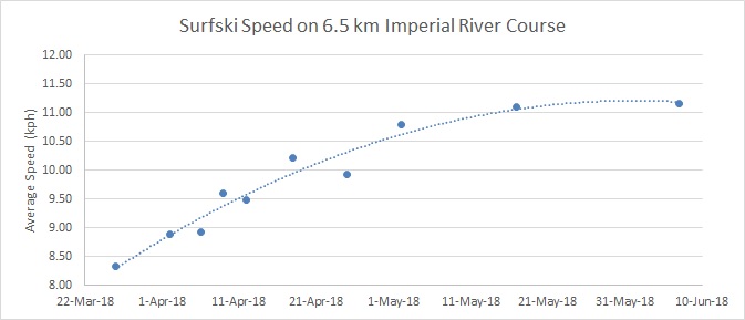

Hi all,
I'm pretty new to surfski but I'm working hard at it. My speeds went up quickly as my stability went from terrible to OK, but now I've kind of hit a plateau (see figure).
What do you all remember from your surfski learning experiences about things that helped you get faster? Was it a gradual thing that came with time, or were there specific breakthroughs in technique, training, or gear that helped a lot? And how fast are you, if you don't mind me asking? I'm trying to figure out what's a good benchmark flatwater speed for a 39 year old prospective amateur racer to aspire to.
Thanks,
James

7 years 11 months ago #31831 by d0uglass
Thank you for all the advice. Seems like there's some consensus that sprint intervals are a good bet, both for the kayak-specific muscle building effect, and for the short enough to practice good form the whole time effect.
Yesterday I tried to apply that advice to a 10x200m/60s rest intervals workout. I definitely felt challenged in the right kind of ways, and I have some good soreness today that suggests the muscles got worked. I had super speed for the first one or two of the intervals based on unsustainable use of my arms, I think. Then that wore off and I had to search for speed in other ways on the remaining intervals.
Do you find that gym work is really helpful, or is more time on the water a better bet if time is limited?
Stellar SEI 1g

How many times a week do you get on the water. I see you are running a 6.5k course. Have you tried throwing in some longer distance paddles, say 10k-20k? Also, try tossing in some short interval sprints next time you are on the water.
I'm 43 (close to your age), 6ft 196lbs and I go to the gym at lunch about 4 times per week and paddle in the mornings 4 times per week. In my Nelo 550 I average about 11.2 kph on a 10k course.
