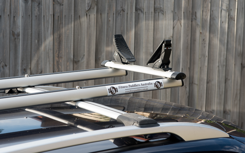

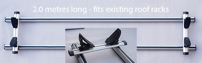

We developed a Ski Transport System that allows you to travel your ski more safely in cross winds with much less pressure required on the tie down straps to hold the ski in place and dampens the vibrations during travel as the ski is supported in equal thirds.
It can be easily fitted to existing roof racks and matches current low profile roof rack systems.
Hope this helps.
For full info see www.fitnesspaddlers.com.au
