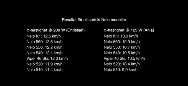

I found this video where all the new nelo surf-skis are speed-tested (power controlled, which is awesome) and also compared with other "old" models as 510, Viper surf-ski & K1 7:
Needless to say that speed of the new models on flat water is very, very impressive -> 560 is as fast as K1 7 and 550/540 are both faster then Viper...
I would love to try one of those and probably buy 540 or 550 as a step up from my (old model) 520.

6 years 3 weeks ago - 6 years 3 weeks ago #36582 by zachhandler
Replied by zachhandler on topic 2020 nelo surfskis
I am not surprised that the 560 is the same speed as a K1. My understanding is that all elite skis are,  depending on paddler weight, with athletes under 75 kg or so faster in k1 and those over 75 faster in ski.
What does surprise me is the poor performance of the viper 46 ski. It is only 0.1 kph faster than the 520. But the 520 has loads of secondary stability and is the most fun beginner ski I have been in.  The 520 is a blast downwind. The viper 46 probably has a narrower catch but I can’t think of any other advantage to that boat over the 520.  Maybe it has more k1 like ergonomics with a higher seat? That is just a guess.

6 years 3 weeks ago - 6 years 3 weeks ago #36585 by Helldiver
Replied by Helldiver on topic 2020 nelo surfskis
One thing to note is that most of us only have experience with the "old" model 520, while the tested model was a new 2020 520 with completely different hull.
In fact I think better approximation of the old 520 speed would be 510, since they have the same hull and same stability, granted 520 should have slightly less drag due to the composite construction (better surface finish) but if the tested 510 is a new boat and the plastic hull is not "fuzzy" from scratching, that shouldn't be a big factor.
And as you can see, 510 is significantly slower then any other boat tested, my opinion is that the old 520 (I own one) is somewhere between 510 and new 520 speed-wise (probably closer to 510...) which has been my experience as well -> It's a great ski, fun, super manoeuvrable, but I don't think speed on flatwater is one of its strengths.
So I get that Viper 46 ski did make sense in the past, being faster then 520 (probably as fast as "old" 550), but with the current range, not so much.

6 years 3 weeks ago #36588 by Helldiver
Actually, that speed testing is one of the most controlled I have ever seen -> he is apparently using real-time power data (strain/power sensor on the paddle shaft) and correlating that with actual speed on a protected lake with no current and very little wind.
It's way, way better then almost all the other tests where paddler is testing different boats and comparing speed "while doing approximately the same effort", because holding that's next to impossible (fatigue, seating position, stability...) and the only way to control that is with power sensor.
In the cycling community, there is an established protocol for testing the aero properties of the bike (or rather bike-rider combo, since rider/riding position is more important) in real-time conditions called R. Chung method where you can very accurately predict real CdA value using speed/power data with some constraints such as not using brakes and using a loop course -  anonymous.coward.free.fr/wattage/cda/indirect-cda.pdf
Those constraints wouldn't be necessary if one could find testing course with absolute no wind, which is next to impossible, but for boat, it's not that hard at all to find body of water with no current.
Of course one can question the quality of sensor data and some sort of pitot-tube sensor for measuring true water-speed would be much more sensitive/accurate then gps, especially for low speed the boats are moving at.

6 years 3 weeks ago - 6 years 3 weeks ago #36589 by uk gearmuncher
Replied by uk gearmuncher on topic 2020 nelo surfskis
Helldiver wrote: 1) It's way, way better then almost all the other tests where paddler is testing different boats and comparing speed "while doing approximately the same effort", because holding that's next to impossible (fatigue, seating position, stability...) and the only way to control that is with power sensor.
2) In the cycling community, there is an established protocol for testing the aero properties of the bike (or rather bike-rider combo, since rider/riding position is more important) in real-time conditions called R. Chung method where you can very accurately predict real CdA value.
1) I completely agree that power is the best unit to use. However, without multiple runs, the results here may not be meaningful. It isn't the only option to produce robust results (we have used the 'stroke index' for this too but granted, power output is superior).
2) Yes, its now well established. I'm friends with Robert Chung and validated his method for use scientifically for cyclists on a velodrome (when compared to the 'gold standard' of the wind tunnel) in a journal a couple of years back. There is also the Martin method too. These days, many of us in the cycling community use tools such as Garmins Alphamantis real time measurement system or bolt-ons such as the Notio Konect.
Fundamentally, the approach in the video is very good but they need at least 5 or 6 runs of each boat so we can see the accuracy and precision of the boats testing as well as the power equipment itself (and that's if you settle for the fact it's only two paddlers). Granted, that's a time consuming process. When I did this with SUP boards, it took me 2 hours to compare the impact of three fin changes on a single board or comparing two board designs. That was 6-9 runs of each variable, a 300m measurement distance, randomised running order, and only using windless and calm water conditions. It took 3 attempts to get the right conditions and it does invalidate the results if it's not completely calm. What stands out for me is that the error of the testing itself could easily be as great as +/- 0.1km/h when you compare the results of the male and the female paddlers.
