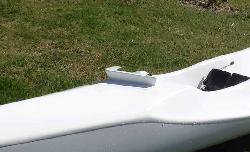

7 years 5 months ago #33296 by paddlepop
absolutely essential on my V5.  looked too small to be useful but sprayed it white and stuck it on with white cloth tape and there it's been for  6 months

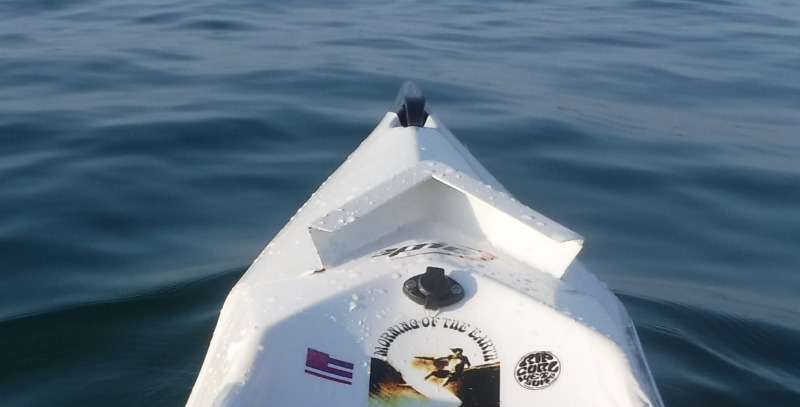

7 years 5 months ago #33303 by Stew
Replied by Stew on topic What's the wave deflector for?
Here you go mate. Full carbon, weighs just 36gms, flexible base to mold to the deck of any ski, and no water in your face.
7 years 5 months ago #33310 by tve
Replied by tve on topic What's the wave deflector for?
@stew that thing looks worse than mine, all the water must get deflected upwards...

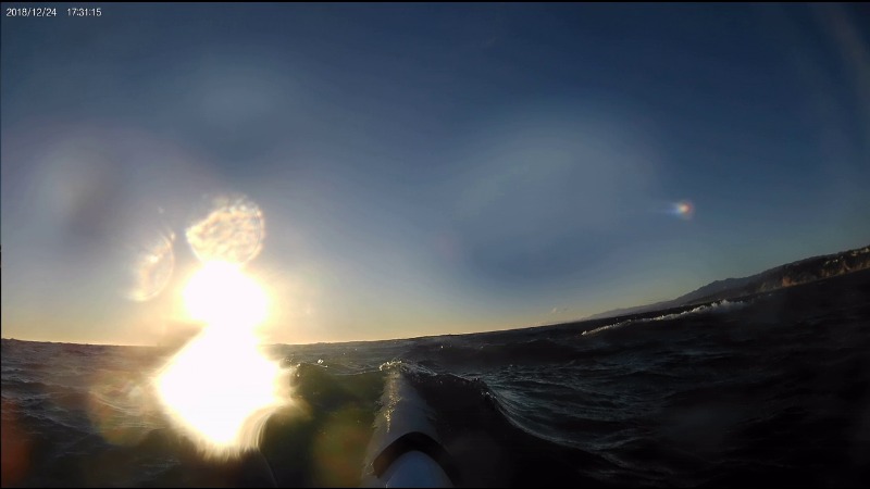

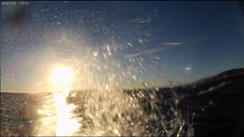

Here's a three photo sequence heading into steep waves that are just overhead. The first shows the tip of the ski digging into the wave, the second the water being thrown up, the third the wind blowing it all into my face (the camera is on my head).

7 years 4 months ago #33372 by CrabStick
I also have the think deflector mounted easily with 2 strips of rail tape to my Carbonology Boost LV (called aLVin). It’s primary purpose is to reduce entry of water to cockpit on downwinders and it does this very well. Water coming directly front-on is split into 2 streams and hardly any is sprayed up.
Going upwind it only occasionally sprays water up. Worse is a wave hitting obliquely eg 45 deg from the front where it can splash, assisted by wind. A minor trade- off for me.
Interestingly, my Fenn BlueFin S also splashes with oblique upwind waves without a deflector so maybe it’s not entirely the fault of the deflector.
There is a potential downside to the design of paddlepops version in that water hitting hard from front-on will try to lift it and may make it harder to keep it secured to boat. The Think one from Stew is mostly pushed down by oncoming wave and seems to split wave cleanly with appearance of laminar flow: fast and not turbulent. This I can only support with my own lame experiments aiming water at it with a hose.

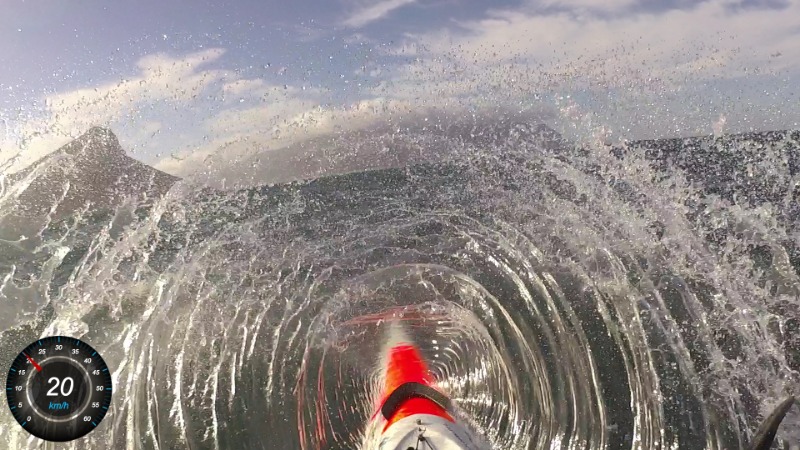

7 years 2 months ago #33674 by [email protected]
The primary purpose of wave deflectors is to make pretty pictures like these:
Just kidding.
I hate paddling either my swordfish or the V10 double in rough water (and especially downwind) without a wave deflector.  If you really bury the nose the deflector can send great gouts of water into the air, which land on your chest and/or face, but in general it really is most effective at helping to keep the cockpit dry.
I got mine from Nelo and really like it; it seems to send most of the water sideways instead of straight up.
